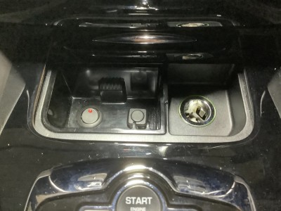

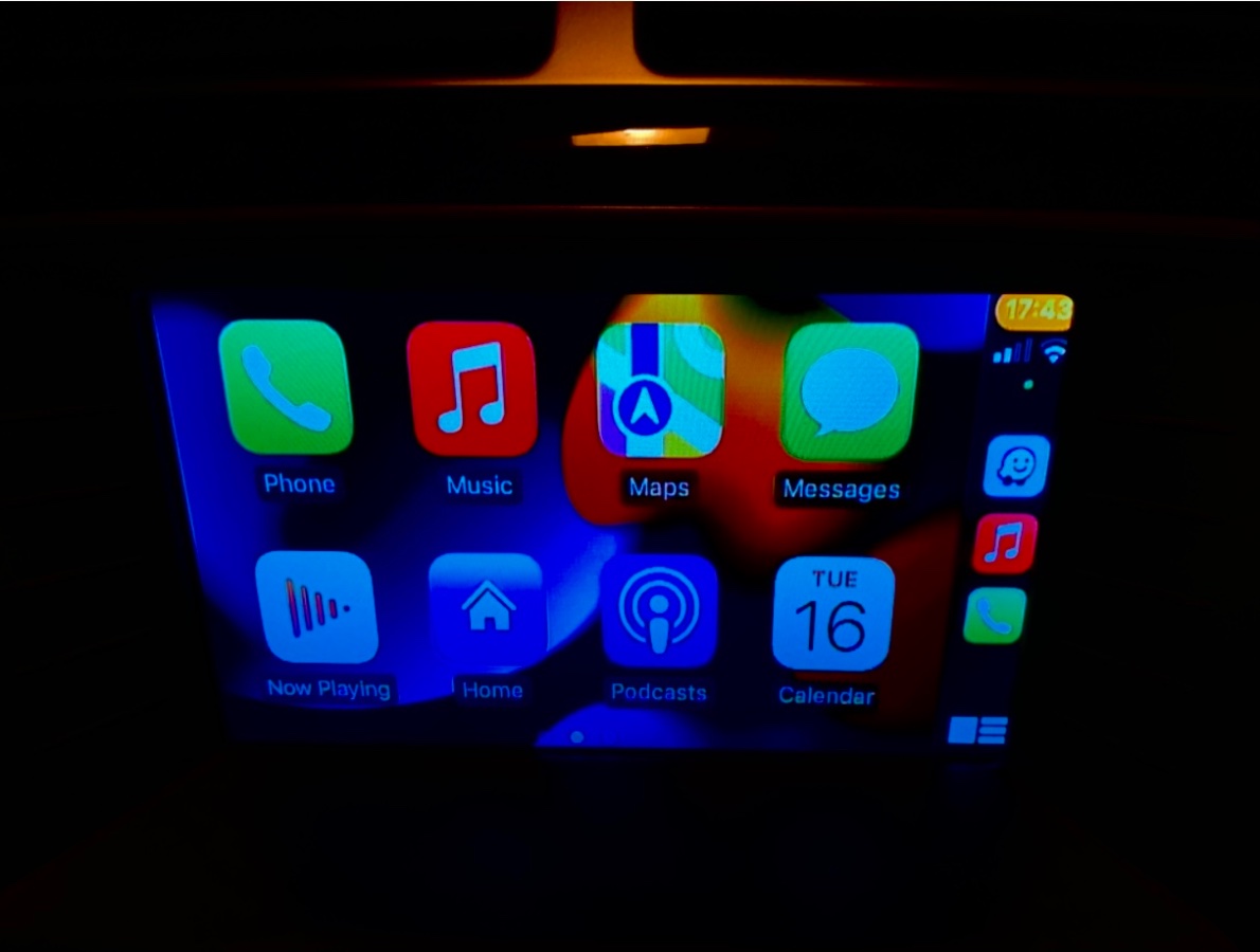

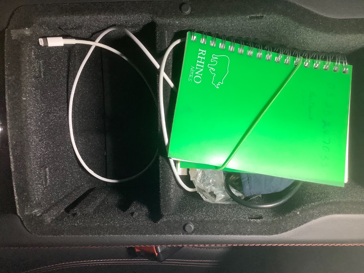

Mike hope this helps all the co pilots out there The cost was £1690, the old system nothing changes it stays the same, there is a lead in the armrest to plug into the IPhone because my phone is quite large I took out the cup holder which I have never used to give me a larger space for the phone, two buttons I had placed in the ash tray one is to switch the Screen to Apple CarPlay the other is for the sound. Sequence is,
Plug IPhone in, start the car old screen comes up press mapping on screen then press button screen goes to CarPlay then press other button with tell tale light for sound. The lads at Byfleet were so good and the installation was nice and neat. If in the future one wants to remove the system a new ash tray placed in the holder and everything is back to standard.
