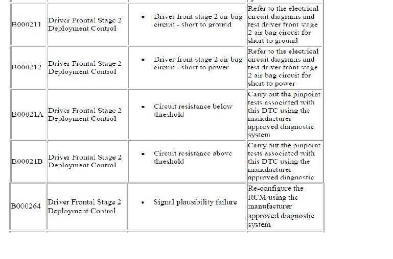

Further to Jimbo's help, this is the full list issued by Jaguar of the B0002 DTCs with the probable cause listed for each sub code
With those sort of faults and the situation that seems to have started the fault, it would seem that an investigation of the clockspring area as suggested by Jimbo would be a good starting point.
