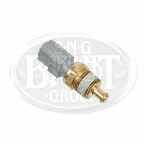

Just had a look on the SNG website and found this part: Which has Part No XR858700
Described as Sensor-Tempe which is the Engine Oil Temp Sensor .
I wonder if that is the part you have.

Yes it certainly looks similar, from memory it was located below the water pump / thermostat housing, I took photos at the time I was planning to fit it, but I think I must have deleted them.
