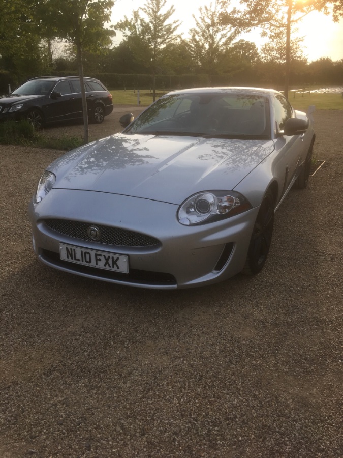

Hi team,
I have a 2010 XK Portfolio. I love the V8 sound I get from her but would like a bit more of a burble at times. Does anyone know of a company that does upgrades with some kind of on/off switch? Thanks in advance. Martin
