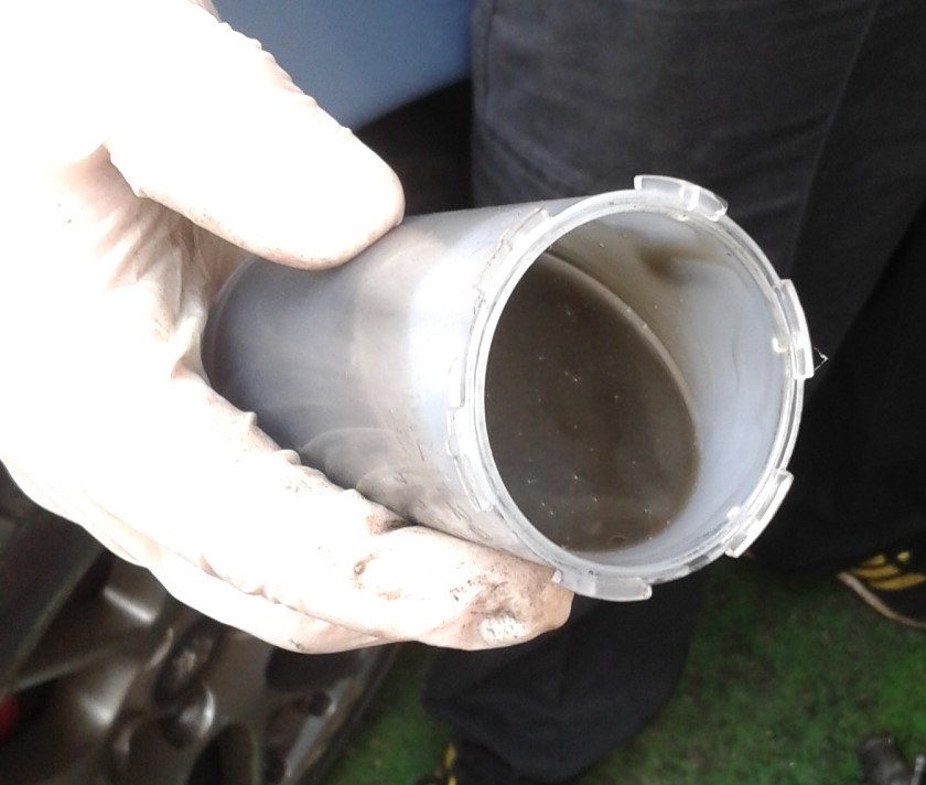

For the 4.2, supercharger oil changes are shown as every 60k Miles.
My XJR 4.2 despite having a Stratstone stamped 60k service, was in desparate need of a charger oil change at 79k miles. It was at that mileage that I bought the car. Then I started getting the car straight again.
What I extracted from the charger is shown here.
Black and evil smelling. What the charger was running in, certainly was no longer good oil. Totally clapped out and fit for nothing. 50k charger oil changes for me from now on.
If you think that oil was bad, suck out a sample from your diff! Similar to above immage. 90k on Jag service sheets. In my opinion, 60k intervals would be more realistic.

Sadly, Jaguar lists the X150 supercharger as, 'Sealed for life' and we all know what that means... Mike.
