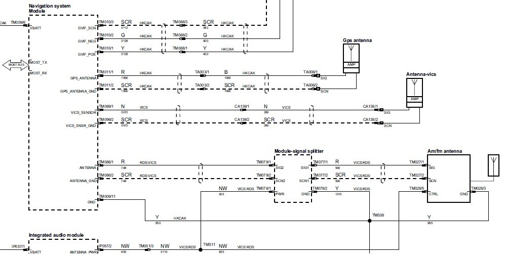

Does anyone know if there is wiring of some kind between the aerial and the actual SatNav? Or does the aerial plug straight into the SatNav? If it plugs straight in, we're (myself and the independent) thinking that the problem may be with the box? If it's the box, I can get a second hand one for less than £100 (don't know if that's good or bad!!??).

I'm not particularly familiar with the X150 sat nav, but I do have the electrical drawings and this is the one of your sat nav antenna connection. I hope that's of some help to you.
Note there are two connectors in the antenna wiring - TA003 is a two wire connector, official colour is Curry! situated on the righthand side of the boot and TA008 is in the boot lid. No colour/size stated. It's probably worth checking them for tightness or corrosion.
The VICS antenna is for Japan only. Not fitted in anywhere else.

Thanks for that.
Electics and electronics not my thing, but I’m sure between myself, the dealer and/or independent, we can come to a sensible conclusion. One that keeps costs down and resolves the issue!
