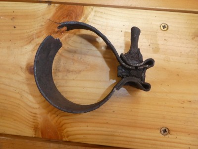

I was investigating a rattle from under my car - 2005 built XKR-S Coupe.
I found that one of the exhaust clamps was broken and had worked its way down the pipe well away from where it should have been.
I think this may have been the source of the rattle but I don't know yet.
The Jaguar bracket is showing as available for back order. As well as being £25.
Is it something special? Is there any reason not to use a normal exhaust clamp?

Hi Andrew, given that the "Jaguar Clamp" failed in service, we can deduce it is not that special and, personally, I would rather have a clamp in place than wait at Jaguar's pleasure for something that they don't manufacture and won't allow their third party supplier to advertise as available next day from the original source.

Thanks Jim.
I thought the same!
I will source a suitable wide clamp.
