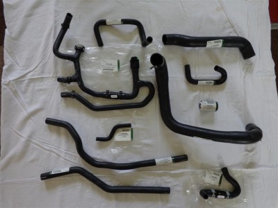

I have now changed the major cooling hoses on my car, a 1998 XK8.
Why did I do it; well primarily because the car is now 15 years old and things will not last forever. I also remember Dave Marks saying at a seminar I went to something along the lines of “…you’ve got to remember that on the continent that Jags are regarded as exotica, and on that basis take spare parts with you or change a suspect part before you go”. Well my car is a LHD one and most of its miles are done on the continent.
Virtually all the procedure I used was based upon that written by Bob Bates and published in the August 2008 issue of the club magazine.
Whilst doing the job I also changed all the spring hose clips for stainless steel jubilee type ones; again I vaguely remember Dave Marks saying that the spring clips can weaken with age.

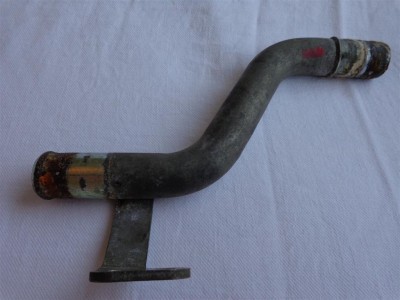

The metal pipe used to carry one of the heater hoses to the more complicated Norma fitting, was heavily covered in solidified material at both ends. This was cleaned with a miniature wire brush attachment and a Dremel hobby tool.

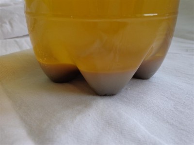

I also noticed that sludge formed in the bottom of the bottles I used to gather and store the removed antifreeze. I don’t know what it was but I decanted the antifreeze to remove the sludge before re-filling the cooling system. I also flushed the radiator through as well.

I've used the word sludge but the stuff I decanted out was more of a liquid that a solid; if I agitated the bottle both liquids would flow and then settle out. It looked more like two liquids in a bottle that would not mix well.

Have a look at this picture I took at the time of the coolant with sludge. The bottle was a 2 litre Coke bottle, doesn't look like oil to me.

Hi Doug. I agree that doesn't look like oil to me either. I would expect it to be floating on the coolant if it was.
My best guess now is that it is aluminium corrosion deposits, but I'm colour blind so it is only a guess. A small amount of corrosion/erosion is normal but this looks more than I would have expected. Are you sure you have/had the correct antifreeze /water proportions?
The only other thing that springs to mind is that this could be the remains of your earlier pump blades, but as I'm not familiar with the materials used or what condition they were like when replaced, this is only a guess.
I apologise for any worry I may have caused, it was done with the best of intentions. I now don't think you have a problem.
