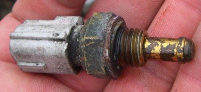

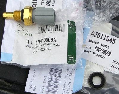

Re: XK8 Temp Gauge went up to red but engine not overheating
Dead easy to fit, Dave.
Buy the new sensor and a new Dowty seal.
Fit the Dowty seal to the sensor and put to one side.
Unplug the wiring loom plug from the old sensor. Take a 19mm spanner and slacken the old sensor in the manifold. Then screw out the old sensor with your fingers. The thread is not a tight one. As the sensor comes out of the manifold, put a finger over the hole to stop coolant poring out. Dis-guard the old sensor, pick up the new and quickly screw it into the manifold and nip up with the 19mm spanner. Then reconnect the loom plug. Job done. I replaced my sensor loosing only a tea spoon full of coolant. Turn the key ignition on and you should find the gauge, the message centre and the coolant level lamp back to normal operation.
As the sensor is right at the front of the engine, access is very easy. You won`t even need to bend over. The whole job from start to finish should only take two minutes and is perhaps the easiest repair you will ever do to a 4 litre V8.
Hi Mike and All,
I have read about your saga with Temperature senders (well several times) and how the same problem it has effected other people.
I have also read that folks have replaced the sender in olders cars, XJ's for example, only to find that the indicator needle of the Temp Guage does not sit in the position that it previously did.
Now, I can only talk about back in the "dark ages" when I was involved in such things.
The sender is a Thermister or temperature sensitive resistance.Now in the case of the old XJ the Temp gauge has a bi- metal strip inside with a piso wire( the heater element) wrapped around the bi-metal strip.When the ignition is switched on a supply goes to the instrument voltage staberliser from there to the input side of the heater element, from the element to the sender(thermistor). As the coolant warms up the resistance of the thermistor reduces,the electric flow increases and the heater temp in the guage increases ,the bi-metal strip deflects and with the neddle attached a reading is given.
Hundreds of thermistors for hundreds of applications are manufactured by differant firms around the world. A time comes when stock levels of all these have to be looked at cos the cost on the shelf becomes prohibitive.So rationalisation programmes are carried out to reduce the number of Part Numbers. In doing so the resistance values tend to drift- hence the needle of the gauge is not quite were it should be.
The reason for writing this is that I noted that David had purchased the sender from a non Jaguar franchised dealer. As time passes I don't doubt that the same rationalisation programme continues to this day. So, my concern is that folks buy a product from a rationalised range and run the risk of building in a problem that was never there
Unless you can be positive that the resistance values throughout the heat range is identicle I would advise sticking with the OE (original equipment) as shown in the photgraph in Mike Kennedys article on this subject
I better stop "rabbiting on" but I hope this creates food for thought
Regards Oldtimer

Very nice appraisal of the state of the nation as regards the whats and whys of these units Oldtimer. (Phil)
I have it in mind that with sensors and similar units, that OE manufactured and supplied units are possibly the only reliable way to go. Odd ball after market units could well be "off the charts" and the hassle and nause of having to part out, recover costs and then have to source and fit replacement parts for a second time, makes the idea of having to do the job twice, a no brainer.
I paid around £13 for a genuine replacement temperature sender so the cost is hardly worth trying to diminish by further window shopping. I took the view of order from a reliable source, install, check as operational and then forget for the next ten years or 77k miles.(Which ever comes the sooner!) This important but boring part in my opinion has to be the correct item but after that assumes pretty mundane interest.
Further to my posts on the S-type BB in relation to this identical part, I would certainly advise carrying or fitting a replacement unit in any V8 model Jaguar (of in my case 77k and ten years of age) as preventative maintenance and prevention of the issue as shown in the posts above.
Mike K
Mike K
