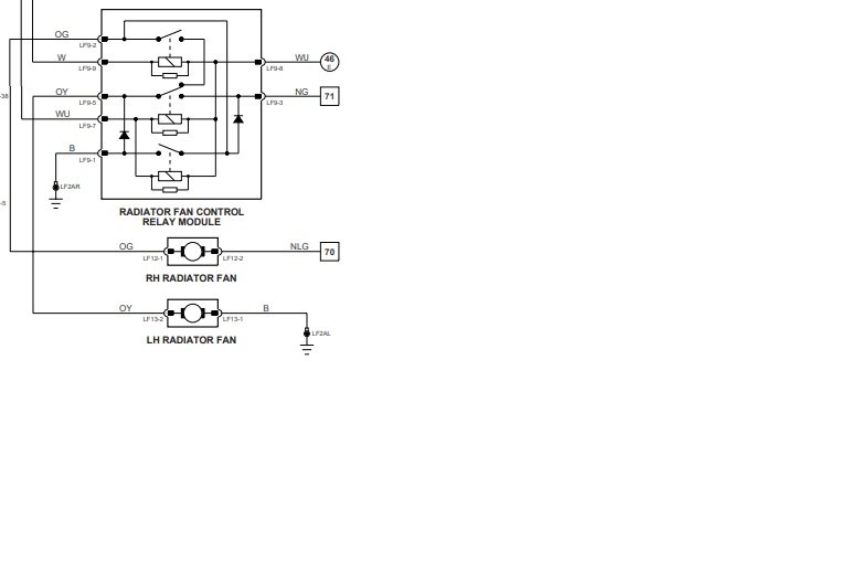

The fans' operating logic is described in JTIS as follows
Cooling Fans
The two radiator cooling fans are mounted in a cowl assembly within the cooling module. The fans are controlled by the ECM dependent on the demand from the cooling system (temperature) or the air conditioning system (pressure). Outputs from the ECM control the radiator fans control module, located behind the left hand side of the bumper, to operate the fans in the series mode (slow), parallel mode (Fast) or Off modes. Hysteresis in the temperature and pressure switching values prevents 'hunting' between modes. Under hot operating conditions, the fans may continue to operate for some time after the engine has been switched off, but will stop automatically when the coolant temperature has been sufficiently reduced.
The relevant circuitry of the module is here
The white and white/blue wires going off top left, both go to the ECM, to be switched to ground as necessary for the conditions at any given time.
The white/blue wire labelled 46 is a 12v supply from the ECM Fuse box, F12,10A.
The brown/green wire labelled 71 and the brown/light green wire labelled 70 are both 12v permanent battery supplies
Although the module looks complex in the way it organises power to operate the fans in parallel or series, its construction of only three relays and two diodes makes it pretty simple to check each of them if you can gain access, but as Brian says, don't omit checking the wiring as far as possible.
