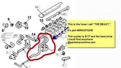

If it is the same hose as fitted on the 4 litre and 4.2 litre S-type R, X350R, XKR and XFR, then that would appear to be a similar issue to that of the supercharged variants.
Certainly on an R, that hose gets cooked to extinction at the front where it joins the rear of there thermostat tower area. It literally fries to death under the supercharger.[attachment=0]
I`d be most interested to hear if the hose that has gone is 2W93-9F814-BC.
Around six months ago, I high lighted this issue on R models in the X350 pages in the magazine. Then and indeed now, I`ve been unable to confirm if this hose is also fitted to naturally aspirated models. It would be useful to know.
