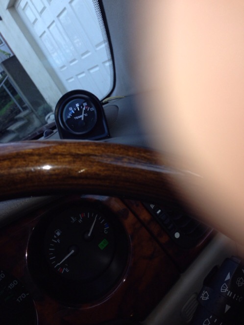

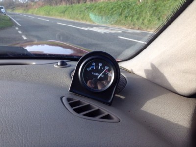

Hi All, I have just changed my water pump and thermostat housing. Having read all the posts I now realise our temp gauges are useless and do not give an accurate guide to temperatures. So from a well known auction site I purchased a temp gauge that reads from 40 to 120 c, it came complete with sender and wiring instructions !!. Also from the same site i bought an adaptor pipe 5 inches long approx with the right diameter to fit inside the top hose already threaded to take the sender. So I cut out a 2 inch piece out of the top hose and fitted the adaptor and sender.
The wiring I ran inside the drivers side wing and in via the drivers door behind the rubber at the corner of the door ( this is not suppose to be a permanent fix just for experimental purposes) In the fuse compartment by drivers right knee there is a fuse for the diagnostic socket that is only live with the ignition, so I used this with an inline fuse for the supply.So I started the car (test done in my garage) and ran at idle for 10 min, The thermostat opens at 85 c and yes temp gauge in car reads normal (mid way) my gauge reads 87 c, I increased revs to 2000 in 5 mins my gauge now reads 95, car gauge has not moved, with temp now approaching 98 I check and the fans have kicked in and temp quickly drops to about 90 and fans switch off. During all this car gauge reads normal.from what i have read the car should run between 90 -95 out on the road.
Now the science...on top of the reservoir it has a pressure reading of 100 kpa...this equates to 14 PSI at 14 PSI water boils at 120 c that is pure water, with a 50/50 mix antifreeze it boils at 126 c. The next test will be out on the road.
All this is for my own benefit but I thought I would share it with you.Please do your own research , do not rely on my findings.
