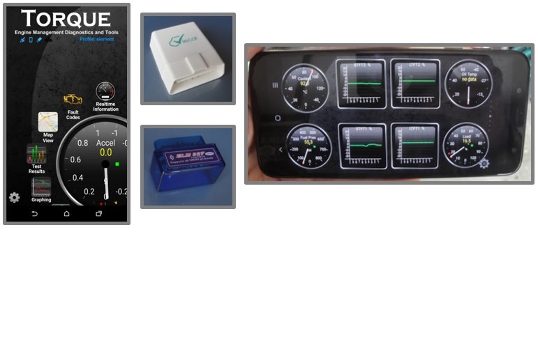

First, the actual value of the coolant temperature is, of course, floating around in the CAN system between the various modules that make use of the information and all you need to read that value is some form of diagnostic scanner. The Viecar that I use and can recommend for quick roadside use is one of these that I keep in my XK8. (Many on Ebay)
There are cheaper versions available as Elm 327, but the see-through blue plastic ones are often of questionable quality
To go with it you need an app on your smart phone. For Android phones Torque Pro is excellent. iPhones have their own range of which I have no useful knowledge. As well as the usual reading of fault codes, you can set up an instrument panel like this and then read your actual coolant temperature in real time
