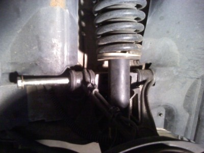

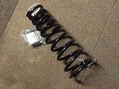

Hi
I have attached a picture of a front shocker assy, note the white wedge spacer and black ones below it. Note how the wedge holds the spring in place, see other picture new spring with wedge spacer fitted to bottom of spring.
I checked out the Jaguar Heritage X300 but it's differant from XK8 don't think parts would do as the spring sits in the lower wishbone same idea.
Click on pic to enlarge.
