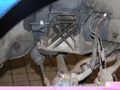

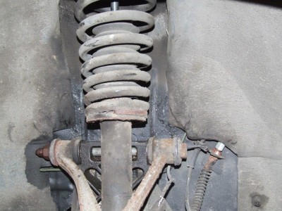

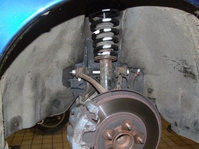

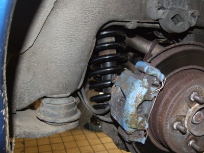

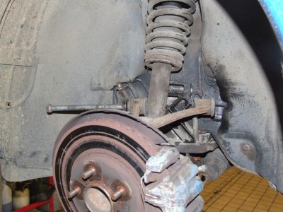

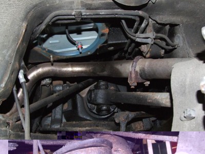

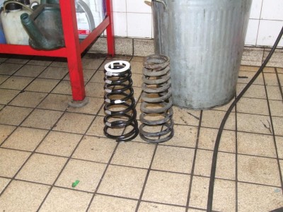

A few pics. of the process, including the different height of old v new front springs. Alarming at first although the ride height is the same. Have put Dunlop sp sportmaxx rt on the front and the car now corners extremely well and far less noise.
Re: '96 super sports/adaptive springs
few more pics, hope I'm not clogging up the process here

Some good pics of the process. I must confess that I always like to get to the point after the springs have been compressed and released even when using the correct spring compressors. It only takes one slip for the potential for damage and injury to be realised in spectacular and horrendous fashion.
In one pic, from the marks of the disc, it looks like the front nearside caliper might be dragging and may benefit from a little attention. Mike.
Hello Mike,
is that on image 1027 (uneven wear?). All calipers need to come off soon for an overhaul, at which time it would be good to get them recoated. Looks pretty grim at the moment.
- Posts:3469
Yes, it is image 1027. The disc surface looks to be scored and rusty, possibly due to a sticking caliper not moving freely, whereas as far as can be seen in the other pics, the offside front disc looks to be in better condition suggesting it may be doing more of the braking. Mike.
