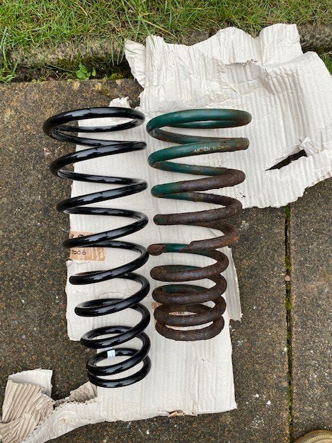

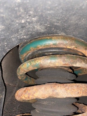

Unfortunately, being a Stratstone car it has green Arden lowered springs.
See picture. This is also giving me a problem because one spring is broken, so trying to find springs that match the Arden's without replacing all 4 is proving difficult. I had some sent by a supplier and they were much longer and with thinner coils than the Ardens.
So not wanting to upset the balance front to back, and not wanting to change the whole suspension at this time I am having a front pair of springs made, but I still want to buy the correct new shock absorbers to match what was on the car originally.
So that is how I arrived at the idea of checking the size of the anti - roll bar.
Thanks again.
Andrew

It's interesting to see that Arden's current springs for the XK8/R (https://www.arden.de/shop/en/jaguar/jag ... -25mm.html) are still painted green, albeit perhaps a different shade, and that they are supposedly designed to operate with standard shock absorbers. Mike.

Just thought I would report in that my car is back on four wheels again with new front suspension fitted.
The Adamesh springs seem identical to the Arden ones so the ride height is perfect.
Thanks for your help, particularly Mike.
