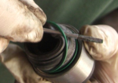

Many thanks to those who have replied. I have sourced a new bush from http://www.jaguarspares-northeast.co.uk at £15(!) and, on the advice of you all, talked my local garage into doing the job for me. I have sent for a 'workshop manual' disc off ebay, which will, hopefully, advise me of any pitfalls I should make my garageman aware of. Mike K - is the pic you included in your reply, one of a series I can access? Thanks again to everyone...Leighton.

The pic was one I took whilst at a garage gathering copy for our magazine.
In this instance an S-type was having new bushes fitted to the rear dampers and I was just snapping away as the job was being carried out. As I watched the job progress, the dampers were off the car and then individually transferred to a bench press.
Once a damper was on the press, the garage used a mandrel to push out the centre of the old bush and make space for a socket to remove the bush outer case. An appropriate sized socket was then used to drive out the outer bush case from the damper register lug. I saw a force of ten tons applied to remove those bushes.
That having been done, a new bush had its leading edge prepared by grinding off a 90 degree entry lead to stop any possibility of the bush picking up on the damper lug as it was forced into position. Again the force indicated on the press was around ten tons. Prior to fitment, the gaiters and retention springs were temporarily removed to provide more working space and eradicate any chance of the gaiters being damaged during bush fitment. Several additional small pushes were needed with the bench press to ensure that the bush was sitting plumb in the middle of the damper register lug.
Pre freezing the bushes does help fitment due to contraction. However, without a press and various sockets, tubes and the odd purpose made mandrel, trying to do this job using a a garage vice, lumps of metal and bits of sawn off scaffold pipe or the like, is not as easy as one would think. You would also need about four extra hands to keep things going well! The right tool for the job ensures a good chance of right first time. Cobble up solutions can on the other hand often go horribly wrong!
Mike K

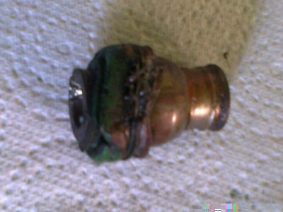

Finally persuaded my local garage to tackle the job. Although the garage is very well equipped, none of their spring compressors were suitable, which resulted in the the removal/replacement of the shocker being extremely 'time consuming' - can't print here how they described the job! As regards the removal and replacement of the bush, that was no problem at all. As you can see from the pic, it was well over due for renewal! If the offside bush needs attention, I've been ordered to hire the relevant tool from the club!

Helpfully, the pic clearly shows that these bushes operate more like rose joints and are not the simple plain shock absorber bushes of older Jaguars. They contribute to the XK8's sophisticated ride/road holding and they usually give audible warning when it's time for replacement! Mike.

Thanks for your interest Mike, and to all others who gave advice, opinions etc. Yes, there certainly was an 'audible warning' - just like a heavy bit of kit rattling round in the boot! Sorted now though. Thanks again.
