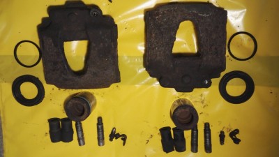

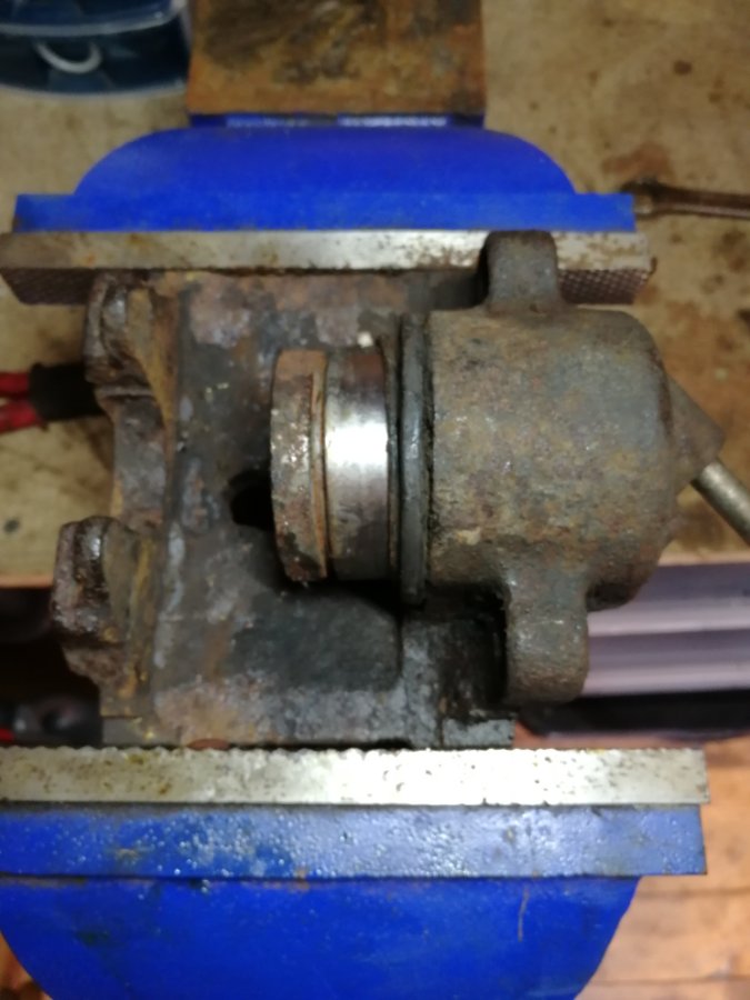

I will just put in my two pennies worth (if I may) of what might be an issue and that is a sticky caliper piston.
They do corrode (they are steel) behind the rubber seal which prevents it returning fully.
The abnormal heat may have caused the brake disc to warp slightly but that does not always happen.
As Astromorg has said should be well within the capabilities of a general garage to sort out.
Good luck with it all anyway.
Here are a couple of photo's of the Jaguar (XJ/XK) brake calipers.

Re: Steering/ braking judder.
Apologies for this very late update. Just for the record, the issue turned out to be the OSF caliper sticking on (You could feel the heat from standing beside the OSF wheel). I had both front calipers replaced, luckily there was no other damage and all has been well since.
