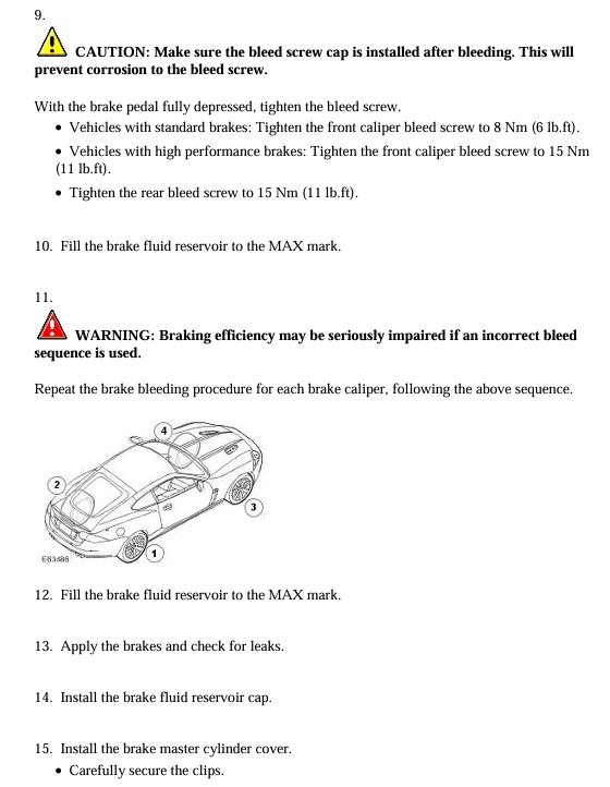

Hi,
I'm just about to replace the two rear brake calipers on my 2006 NA 4.2 Cab. Could someone help with the correct brake caliper bleeding order. I have a couple of workshop manuals, but neither of them provide this information. Furthermore, I cannot find anything vehicle specific online via google or YouTube.
Many thanks in advance for any assistance.
KR Mike

This is taken from the Jaguar Manual
The whole manual can be found here
http://www.jagrepair.com/images/AutoRep ... ervice.pdf
