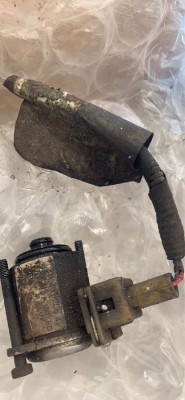

Power steering suddenly stopped operating. Pump is new and tested OK but analysis points to the pressure/speed sensor being at fault. The valve alone is not available - only complete with a new rack which is obviously very expensive. Does anyone know where I can source a new sensor?
I found one online from a breakers but it’s in poor condition so would like to source an alternative.
1999 XKR pressure/speed sensor valve

I've had good service from both of these used parts dealers
https://www.eurojag.com/
https://www.autoreservejaguar.com/
For Eurojag your best bet is to phone them, tell them what you need and they'll usually tell you availability and price straight off. The website is just an indicator of what they might have - or not!
Just a thought; it's not just the fuse blown is it? F12, 20A in the driver's side dash fuse box.
