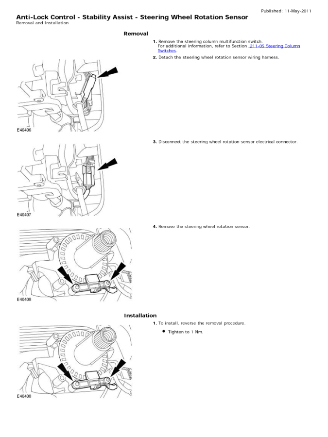

The DSC fault came up on the XKR today, when scanning the fault it shows C1295 Steering wheel angle sensor- internal fault, I assume the sensor needs replacing or the wiring is bad, but I cannot find the location of this sensor on the column, can anyone give me a guide to where I should be looking? Thank you

I’m hoping that I’ve managed to attach a screenshot of the workshop manual. That should help you locate the steering angle sensor. It’s the component with two arrows pointing to it in step 4.
Hope that helps.
