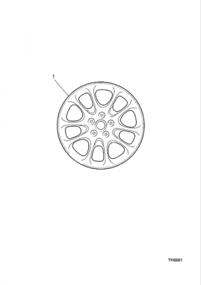

Hi, My 2004 XKR currently sports a set of scruffy 20 inch BBS Paris wheels that I’m looking to replace. Does anyone know of a definitive source that lists which 18 inch wheels will fit this car given brake calliper, bolt pattern etc. constraints. (I had been planning on using 18 inch Hydras, but have just been reliably informed that they will not fit the bolt pattern on my car.)
Many thanks for your time,
Dave Edwards.

Re: 18 inch wheels for 2004 XKR
Hi Andy,
Thanks for your reply. Since starting this thread, I’ve been informed that the seven (double) spoked Hydra 18 inch wheel (C2N3314) will in fact fit my car, and there is no problem with the bolt pattern or fitting around the Brembo brake callipers. As you said, 8J’s are needed at the front and 9J’s at the rear.
Does anyone have these fitted on a similarly aged XKR and if so, how have they found their wheel/tyre combo in terms of ride compliance and road noise?
Thanks again for any feedback,
Dave.
