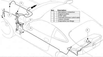

This diagram shows the system
and its the Evap Valve and the Fuel Tank Pressure Control Valve that need to be checked. That said, an evap valve that's solenoid operated might be expected to generate a warning message/ light and the name of the other valve rather points to it! New ones don't seem to be available, but used ones like this are

While the pipework to the valve is disconnected, it should be checked by blowing through that it's not blocked.
