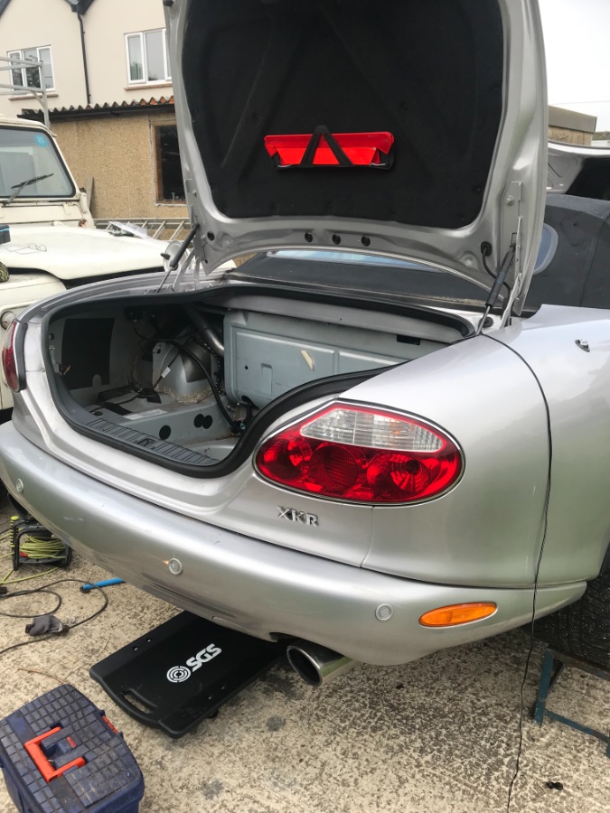

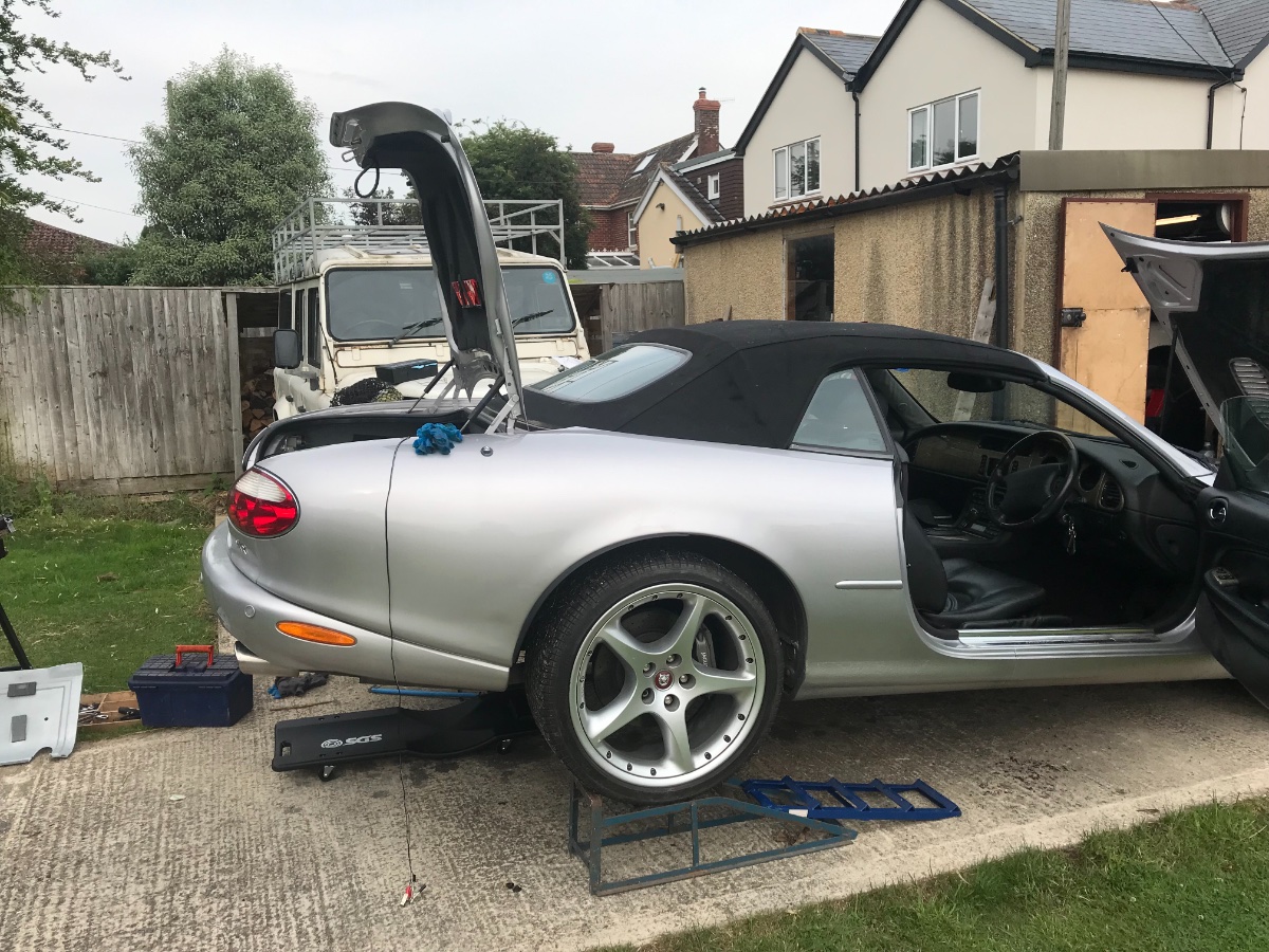

I took the decision to back the car up on ramps for the safest and easiest access both putting the boot at a good-ish working height and allowing easy access to the area around the diff.
I won’t put too much detail about the boot area it’s pretty easy to do:
-Remove the battery! (Sparks, fuel etc etc scary thoughts)
-Remove the rear light covers, interior boot linings, left, right, rear
-Remove the large metal bulkhead that runs across the rear of the boot (5 bolts)
-Remove the pipe work around the fuel filler cap.
-Disconnect a few cables
That leaves you with the fuel tank ready to remove - apart from the pipes at the bottom…….

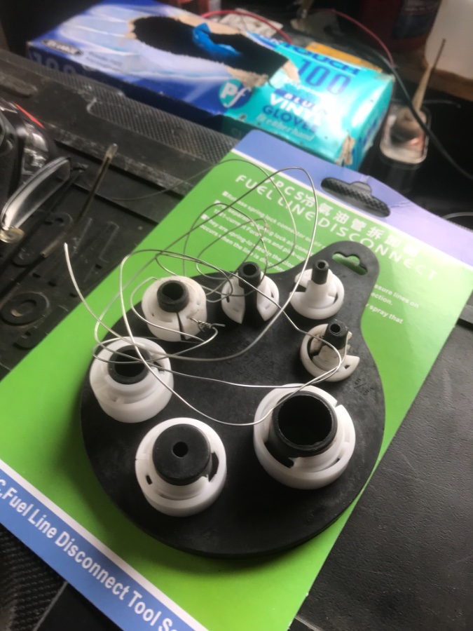

In the picture of the set I ordered you will see the one learning point from my attempts to make a tool and that was to attach wire to the release tool as dropping it happened quite regularly and I lost two before attaching tethers and that would have been disaster if it had happened with the tool I purchased as there is only one of each size.

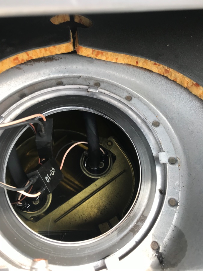

You will see the two (if you have an XKR) pumps submerged in the tank. You need to get a socket in to release the two 7mm nuts securing the pumps. If you are doing this in the car with a tank full of fuel you don’t want to drop the bolts! I had a magnet next to each bolt to avoid upset.
One the bolts are released the pumps can be lifted up. You need to disconnect the flexible fuel line and wiring connector from each one.

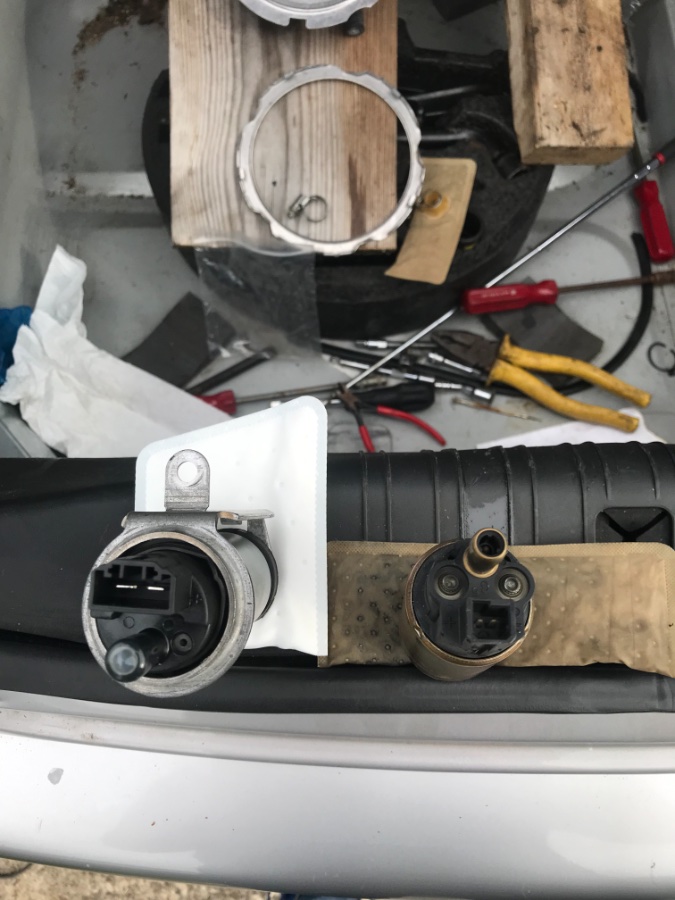

When looking for replacement pumps I saw many places selling lots of different versions with hugely varying prices from £18!!! Each.
I opted for some at around £70 but shied away from the £230+ oe ones.
The issues with the pumps I got are :

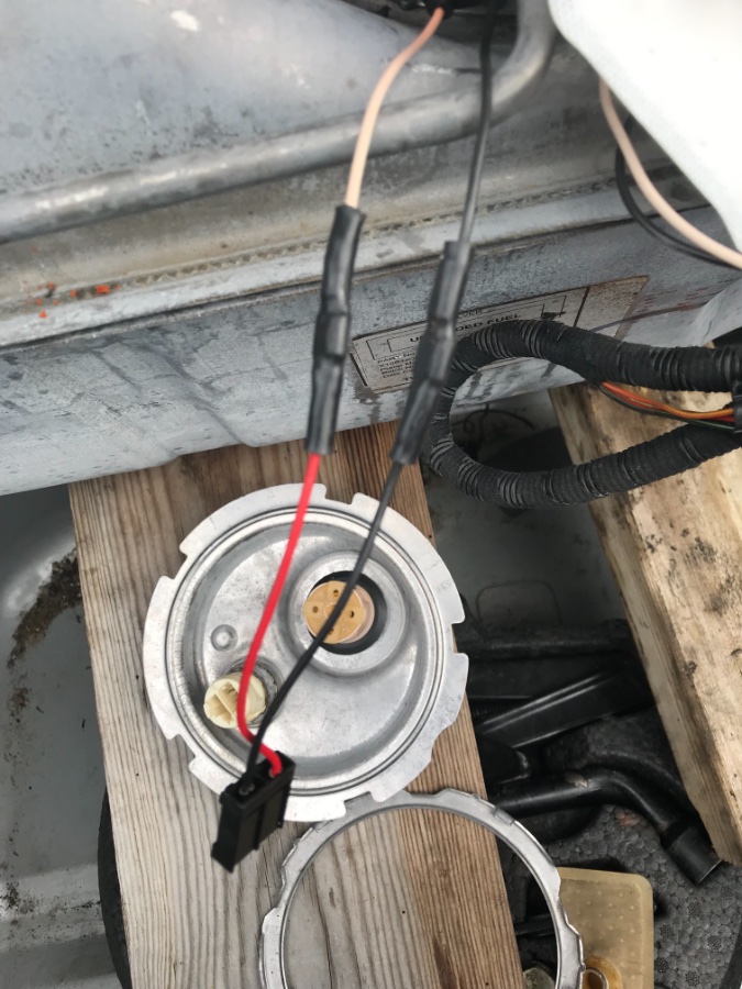

-the new pumps came with a different wiring harness connector which means you need to do cutting and splicing
-The filter bags with the pumps I purchased are fitted 180 degrees out (I;ve included a picture) this gives you a problem as it prevents refitting, I had to mount the filter bag reversed which meant I didn’t connect it;s retaining lug which is hopefully not a problem
The actual shape of the pump is subtly different to the original which means the anti-vibration rubbers don’t fit perfectly which means the retaining bracket is difficult to refit.
In reality for me the wiring connector was the biggest concern as I had to cut off the original connector and make a new loom section that was secure and safe. You don’t want to rush this I removed the cables to the garage (away from petrol fumes ) and attached the new connector with soldered on spade clips protected by shrink-wrap covers. You really don’t want live wires floating around in the fuel tank…
Re-assembly is as the say the reverse of disassembly!
The fuel tank pushed easily back into place.
With my new car crawler I quickly slid under the axle and with the long narrow screwdriver managed to quickly reconnect the pipes.
I quickly tested both pumps using the relay method mentioned earlier
With some trepidation I started the car or rather tried to - still took inordinate cranking before it fired - I’m hoping it might be borewash we shall see later.
In the bright side, I’m back to 2 fuel pumps!

Re: Poor Starting XKR
Seemed to only attach 3 pics on the last post
You see on the picture of old pump and new pump side by side how the filter on the new pump is different and sticks out behind the pump

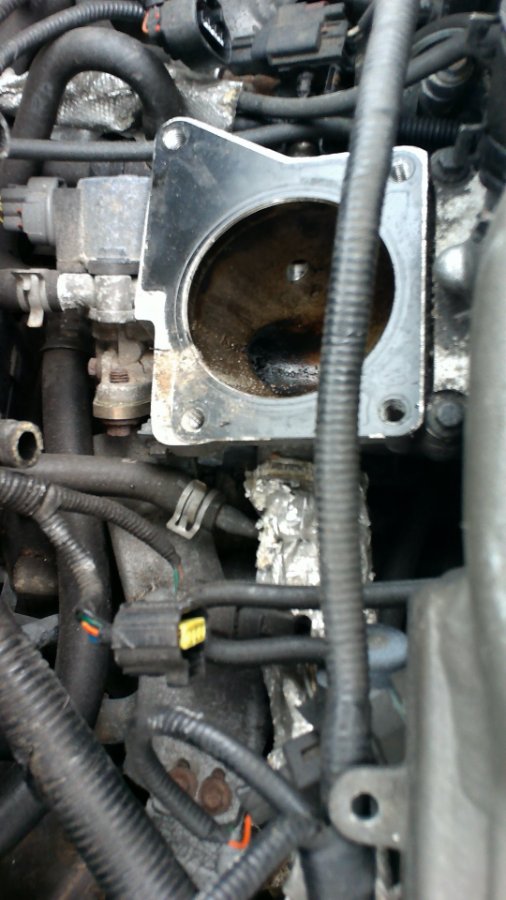

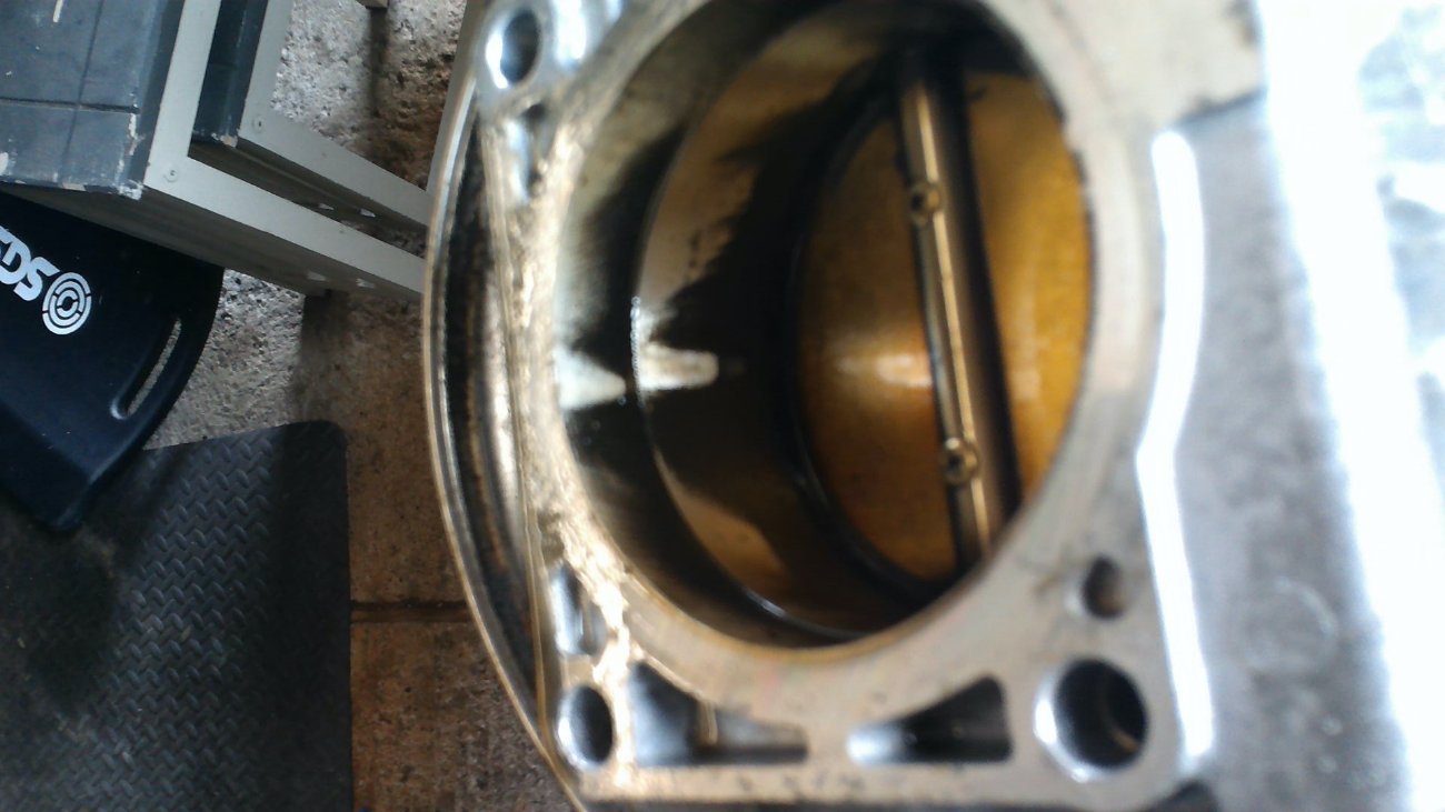

so the journey goes on as two working fuel pumps made little or no difference to my starting woes..
So number three in the list of things to check on TSB 303-55 (difficult/non starting) is the the throttle body. Now I know that the TSB is for the AJ26 versioned engines but I'm assuming that it is fairly sound as a basis for diagnosis.
YOU SHOULD REALLY GET A NEW THROTTLE BODY GASKET in advance of this as you may tear the existing one and it is not good practice to re-use gaskets!
I popped the air cover off the top of the throttle body (two bolts at the throttle body, a breather pipe to the RH engine bank and the large jubilee clip at the MAF)
The first diagnosis step suggest that you with the help of an assistant check that the throttle butterfly opens and closes when the ignition is turned on.
well I failed at the first hurdle here as my throttle just kind of twitched! However, I'm possibly led to believe that the AJ27 Throttle butterfly might not do this (personally I doubt I'm that lucky) Interestingly the throttle is humming continuously with the ignition on which I think is the butterfly being kept closed (there appear to be gaps in my understanding here)
I decided based on the level of carbon I could see inside that bench removal was called for. TSB 310-06 describes this process well although there were a couple of minor differences as it is for the AJ26
The removal process is pretty straight forward the key advice I would give is to ensure that you use a magnet tool at all times when removing the bolts as I suspect that 'dropped is lost'
Also, there is very little space at the rear of the throttle body to get your hand in to remove the hoses, particularly if they are stiff.
There may be disagreement here, but the method I use for 'stuck hose' removal is to gently grip the pipe in question and apply a slight twist aback and forth around the hose to effectively turn the hose a tiny amount on the pipe breaking any grip. The important thing here is gently, you do not want to be ripping and damaging pipes with pliers.
for the lower pipe it was too inaccessible so that although I could remove the clip I could not get anything in to grip and remove it so I left it in place and when I lifted the throttle body I was able to reach and pull it off.
You need to disconnect the throttle cable, something to consider at this point is whether there is too much slack in the throttle cable as you will need to remove the tie-wrap that locks the adjuster in place so if there is a lot of free slack in the cable you can remove some of this on reassembly (mine had loads of slack)
Once you've disconnected the pipes at the back, wiring connections, throttle cable , the air vent bracket and undone the 4 bolts securing the throttle you should find that it really easily lifts out.
I've added a couple of pictures so you can see the view in from the top of the throttle and also the view inside from the bottom with it on the bench.
I used carb cleaner and petrol to remove a lot of varnish and carbon deposits - you should not use any rough tools in the throttle body it will scratch easily and it you are using a paintbrush or toothbrush be really careful that no bristles are left in the body or butterfly mechanism as we are aiming for better butterfly movement not impeded!
So at this point I had some concerns as my butterfly is definitely not closing completely and wasn't before I started. There is no doubt that it is not sticking and it might have been before but there is probably a fraction of a mm of movement that it can be applied against the sprint to close it - now that may be idle adjustment related to the adjusters on the throttle sensor (more stuff to check!)
Anyway, reassembly is definitely the reverse of removal the only difference is that the two cooling pipes were much easier to refit. (remember to use a magnet to get the body bolts in place )
Also check out the free-play in the throttle cable as I mentioned previously - you do need to make sure that the cable is so tight its applying the throttle.
You should also refit the the throttle adjuster to its bracket with a new tie-wrap to secure - I think that the tie-wraps were main dealer applied retrofits to address issues of the adjusters coming out of their brackets.
With the body back in place and looking much cleaner I duly turned the ignition on and saw the flap give a little twitch - but it did not open and close - hmmm do I need to worry about that?
Cranking the engine without the airt cover back on yielded no engine start at all - surely it should start without the cover on.
Anyway, with everything back in place the engine roared into life almost immediately and restarted numerous times after turning off. I let it warm up, drove up to tesco, then went to get fuel. Each time it started as expected.
Hurrah!
Although I'm still not sure if that butterfly should open and close on ignition start.....
