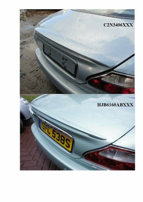

Postby DougX » Sat Jun 28, 2014 7:17 am
Managed to identify the spoiler and the Jaguar Part Number. Found one on a breakers website in Cheshire. Should be with me on Tuesday. For those that are interested, here are the two typs of spoilers and their respective part numbers.
Posts:3469
Re: Jaguar XK8 Spoiler
Postby mike020150 » Sat Jun 28, 2014 10:18 am
Hi Doug,
I have kept digging and there are actually four spoilers listed by Jaguar! HJB6160AA (to VIN 024686) HJB6160AB (from 024687 to VIN A40264); C2N2897 (from A40265 to A42111); and C2N3406 (A42112 onwards). Don't ask about the differences. They may be as subtle as changes in the glue! Mike.
