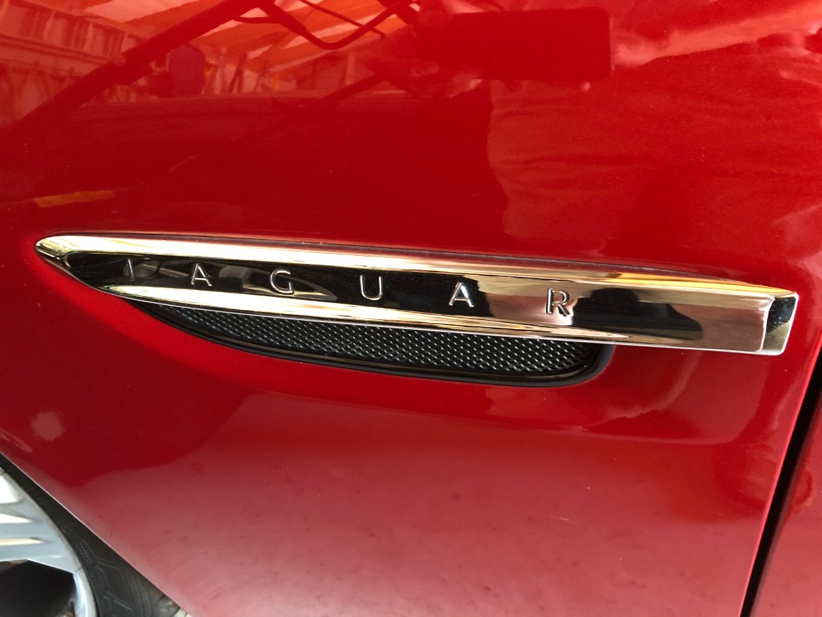

I have a 2014 XK Coupe. I would like to replace the chrome Jaguar badge above the vent on the wing. See attached photo.
Can anyone tell me if this is a straight forward push fit or if it requires access to the inside of the wing?
Thanks.

Just remove or peel back the wheel arch liner to gain access to the moulding's four holding clips which are of the 'use once' variety. Mike.

Many thanks Mike.
Roger
