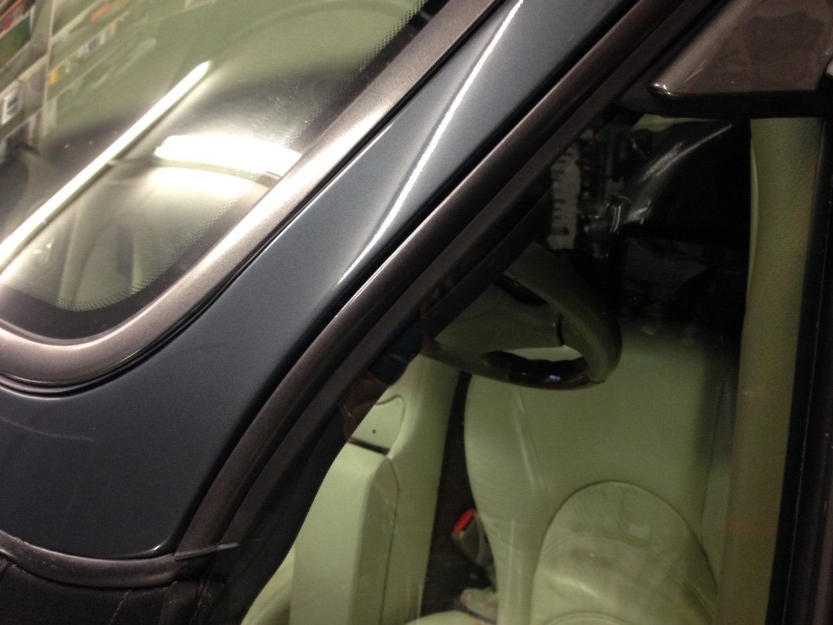

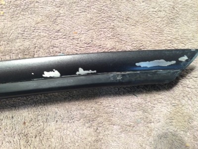

The driver's side A post on my 2001 XKR convertible were looking distinctly rough. The paint was scruffy and coming away and the alloy in the rubber seal was corroding and blowing out.
Here is the top with the rubber seal looking untidy.
And the paint is peeling

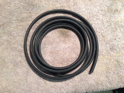

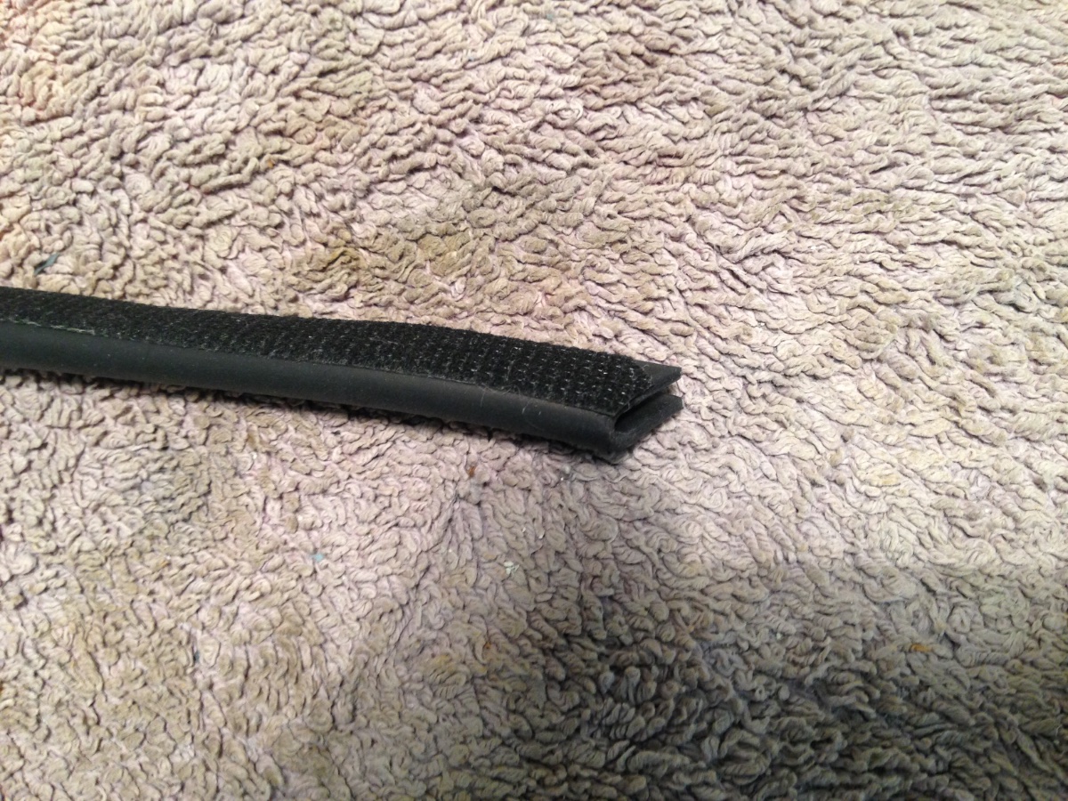

Well the breakthrough was when I found a suitable rubber section that can be used to replace the blown out ones from these guys
And here it is and all for a few pounds

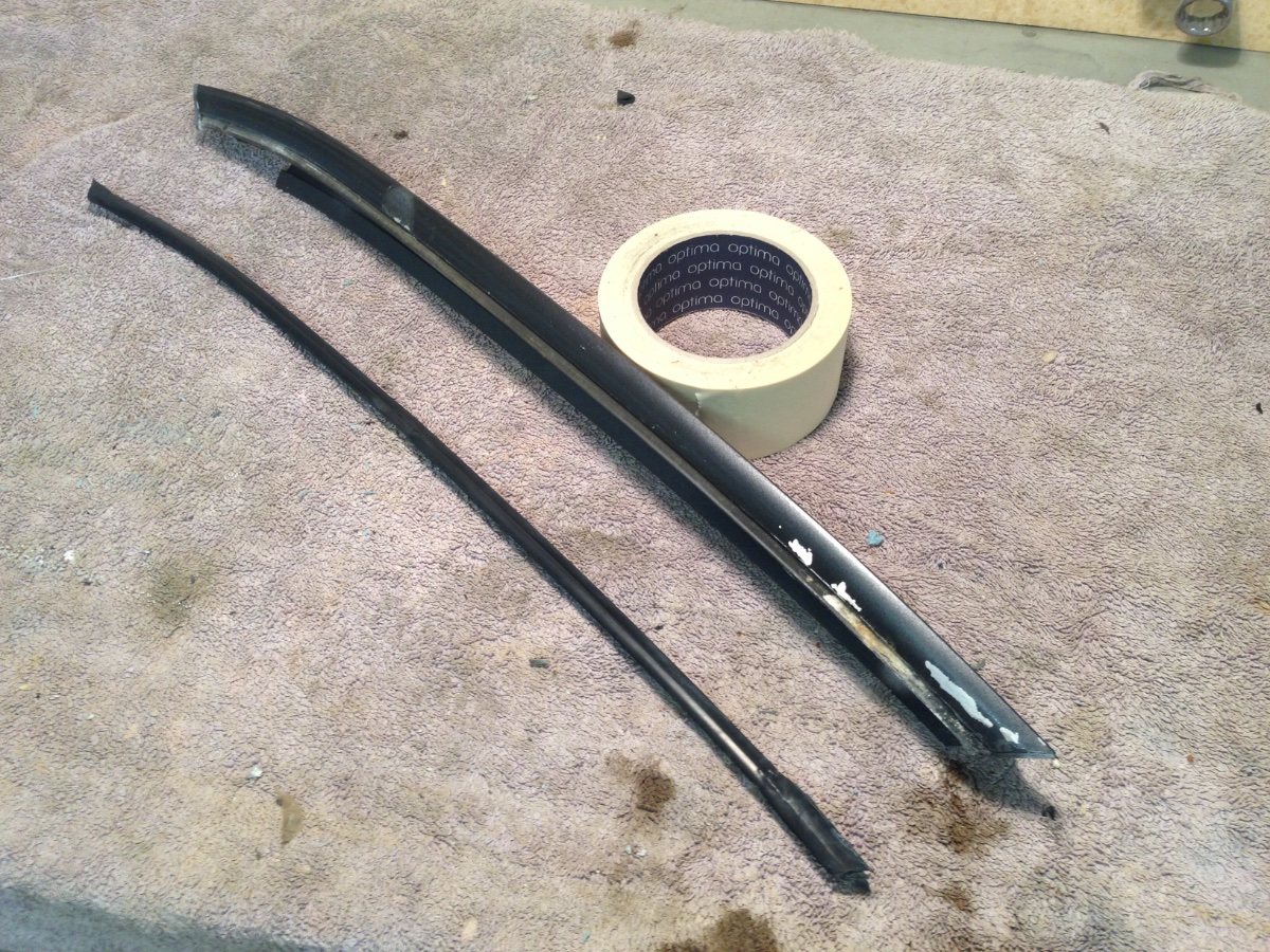

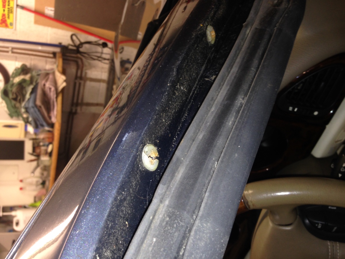

The seal retainer is held to the a post by 5 screws hidden behind the door glass seal so I pulled the rubber seal out of the channel as below.

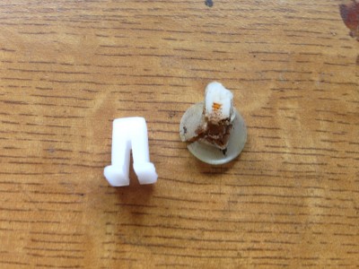

The screws go into captive plastic nuts in the a post. These are called lokut nuts. Mine were brittle and had broken. They are available from Jaguar but again the price is ludicrously ambitious at £7 each!!! So that's £70 for 10 tiny pieces of plastic.
So I got some from eBay for pennies. Here's the old and new
And here's the a post with the seal retainer removed

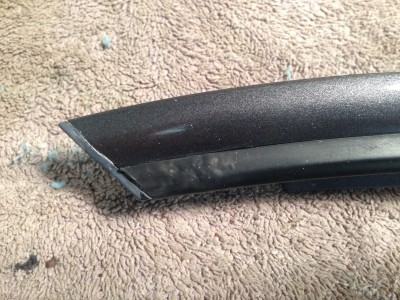

So here's the seal retainer in more detail.

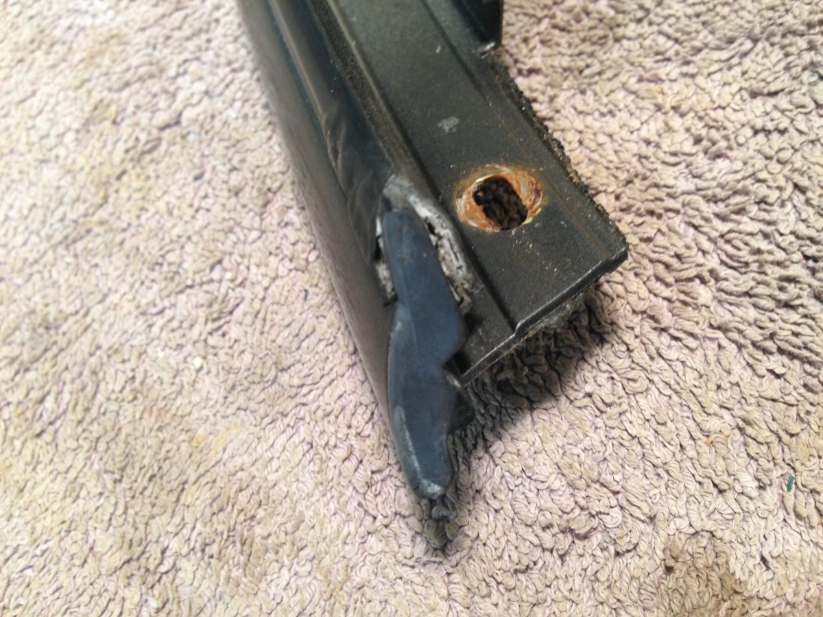

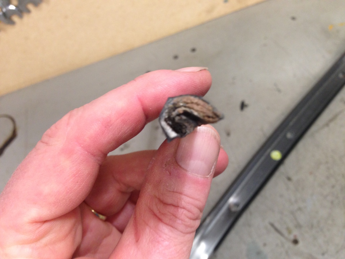

The rubber section pulls off like this
The rubber covers an alloy inner that inevitably corrodes and expands like this

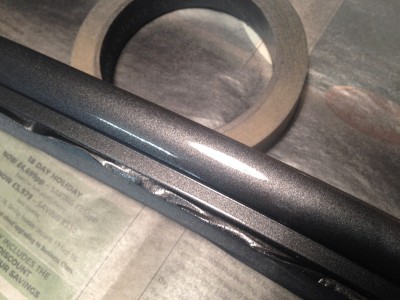

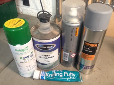

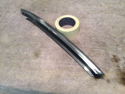

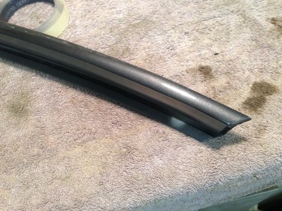

So once the rubber section has been pulled off the alloy seal retainer can be rubbed back and painted.
Once rubbed down and the ends masked off it was primed using an etch primer.
Then it was rubbed back again and got a couple of coats of Dorchester Grey metallic before 3 coats of lacquer.
These were the materials used
The lacquer was allowed a couple of days to harden off and then gently flatted off with 1500 grade wet and dry before polishing up with compound. Using this method, care and patience it's possible to get a good finish

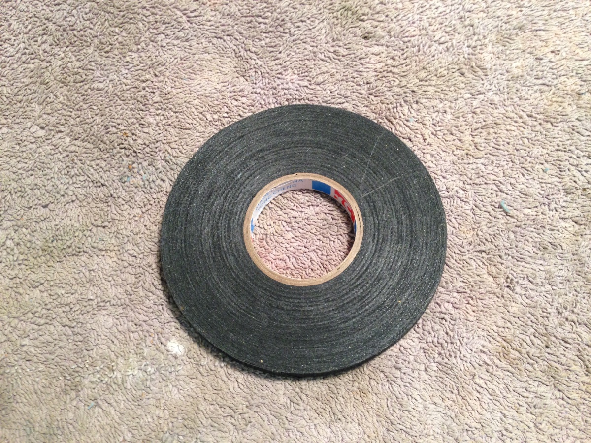

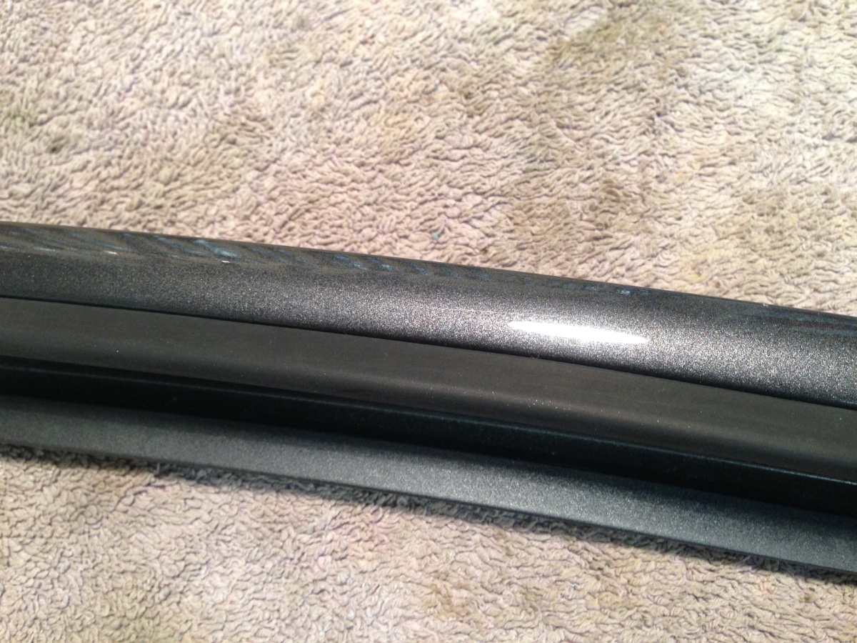

So finally I used the rubber U-shaped strip to replace the blown out one. The only other thing I did was replicate the felt inner strip with tape as below.
The rubber strip was then cut to length and it looks pretty good I think
I've yet to put it back on the car but I'm pleased with it so far and it's cost me considerably less that £444!!!

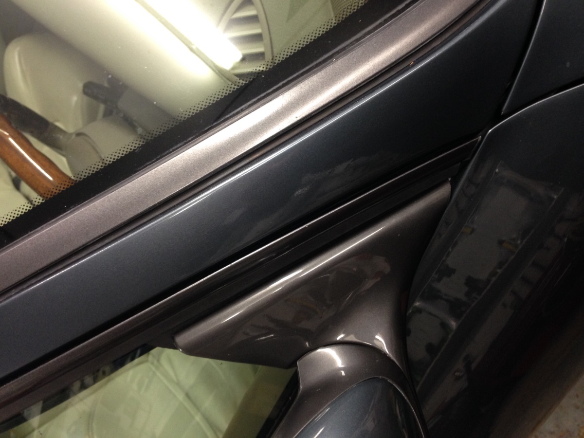

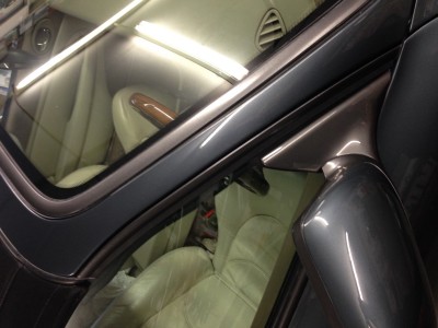

The trim is now back on the car and looking much better.
PPV
Posts:639
Location:Nantwich
Re: A Post trim refurb
Postby PPV » Wed Mar 11, 2020 11:50 am
Looks like new.
