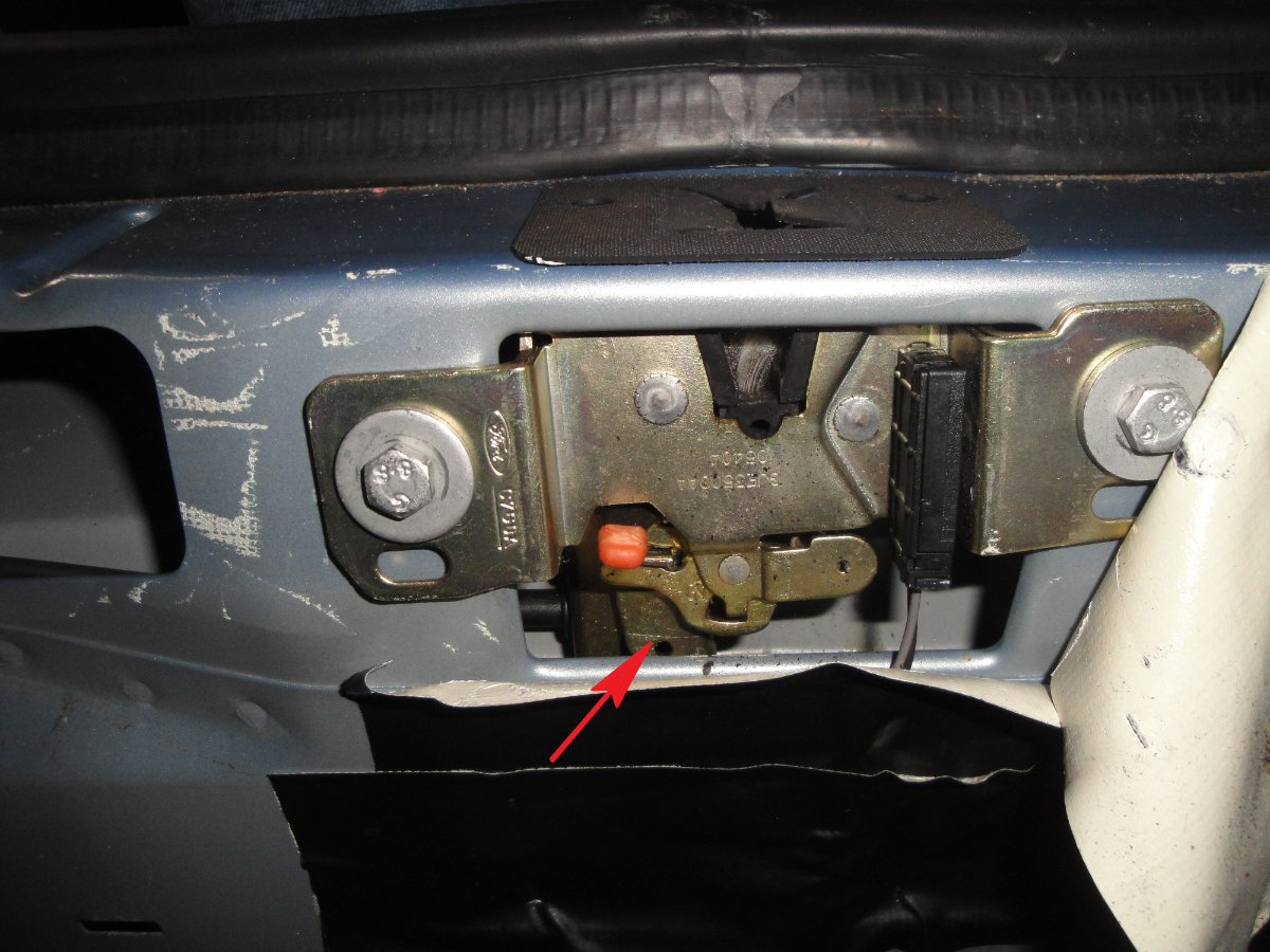

Re: Boot stuck shut
Looks like invasive surgery is required. Fortunately, as in the NHS, keyhole surgery is available that reduces the post operative scarring! You need Post no 49 in this link
https://www.jaguarforums.com/forum/xk8- ... ight=trunk
The only worry is that if the lock is seized (and that may be why neither key nor fob/solenoid will shift it) you should be able to generate a greater force with a decent lever than with the key or solenoid. That combined with pumping may get you there.
Best of luck!

Here's a photo of the boot lock. The arrow points to the lever that has to be levered towards the offside of the car to unlock the boot.
If the lever with the orange cap is moved down, then only moving it back up again will allow the lock to be unlocked by any means.

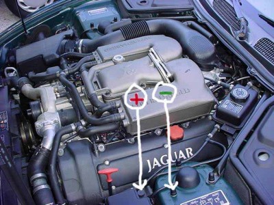

Are you implying that the flat battery is preventing the normal electrical unlocking systems from working and the mechanical key back-up is also out of action?
If it's just a battery problem you can power the electrics up sufficiently by connecting an external 12v power source in the engine compartment. (But it's NOT suitable for jump starting!)

Exactly that. I can't unlock the doors so I can't open the bonnet. The boot key turns freely but doesn't release the latch.
Re: Boot stuck shut
Your key should open the driver's door even with a flat battery. Once you connect the 12V source as suggested above, the alarm will sound, so have your fob to hand.

Hi Andrew, last year I had to gain access to an early XK8 convertible that had been standing out in the open for months, with a correspondingly flat battery. It was a simple operation to use the key in the driver's door and unlock the car. I could then pop the bonnet and fit the boost box to the terminals highlighted by Astromorg, allowing power to the ignition circuit to open the boot. After that it was a case of connecting the boost box direct to the battery and being able to start the car - first turn of the key as well!
In your case, if the car is unlocking - interior handle moving across - it may be a simple case of the fact that it is a convertible and with no power there is no window drop to allow the door to open easily. There should be no other impediment to unlocking the car manually and lifting the external door handle. I can't recollect, but I think there is also a manual key option for the passenger side door as well as the driver's door on the X-100. There is no way the flat battery is preventing access to the car - that would be a serious design flaw that would have popped up before now.
Jim
Jim
