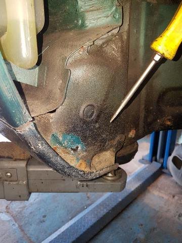

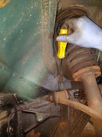

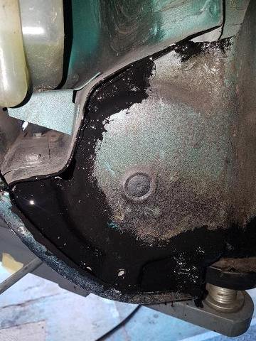

I have been dreading removing the inner wing liners on my XK8 for a couple of years now, dreading what I might find.
After all after 20+ (23 now) it's not going to be a bit rough
My options were
Should I leave it until it's beyond repair (yes I did think that)
Remove and repair whatever I would be confronted with
Or hope it wouldnt be too bad
Well I am glad to say after a struggle with the liners it was number 3. A little bubbling here and there which needed scraping off. POR 15, chassis black and waxed. Check the underneath, subframe etc and treat as before then a fight with the liners again and it was good to go.
I do have some more pics if anyone is interested but it's definitely on the too do list if anyone hasn't already done it and removed the liners because I have seen cars a lot younger than mine that looked fine and they were rotten as a pear.
