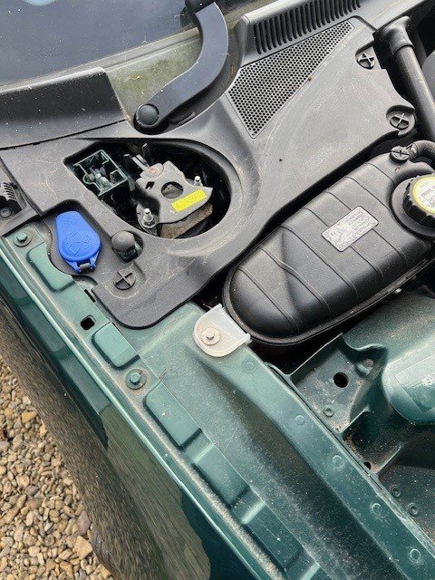

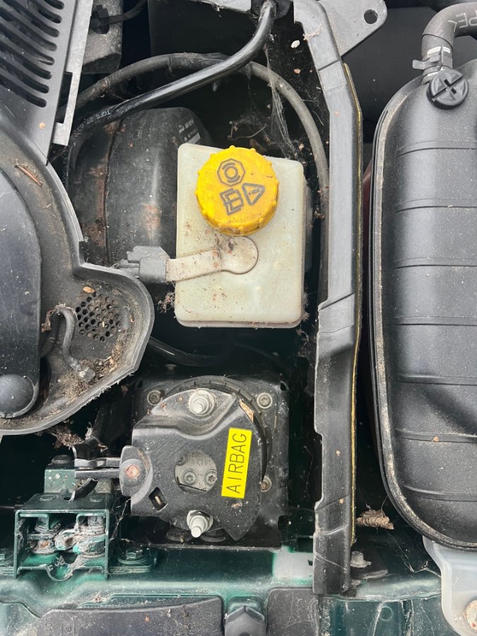

That backup alarm unit is under the cover near the bonnet airbag i beleive. I took off the cover and (apart from a nest of spiders) I can see a small reservoir with a yellow top and a circular black donut under that. The noise is coming more from under the reservoir there and nothing to do with the airbag.
Unfortunately, nothing looks easily accessible to attempt to change a battery (assuming you can get them, the other person said it was the same as Land Rover systems of the same era). I looked in the PDF I have of the manual of 2006-2009 cars but cant find the rechargeable battery mentioned anywhere.
I've attached some pictures below and open to more suggestions!

On the XK8 there is an 'intelligent sounder' mounted below that area, accessible from the wheel arch by removing the liner. This does fail as it has an internal rechargeable battery that dies over time. However I am not sure it is in the same site on the X150. It may be well be this that is giving you the noise.

The alarm sounder is located below the pedestrian protector actuator. There are several versions of the sounder ranging from £70 to £150 from Jaguar, dependent upon specification, and are not difficult to fit. Mike.

The Garage (Autoclassico) managed to source a part and replace.
They said the old one was sitting in water as a drain hole under the Bonnet Airbag thing had blocked up. They have cleared it all out and put the replacement unit in a plastic bag for good measure.
