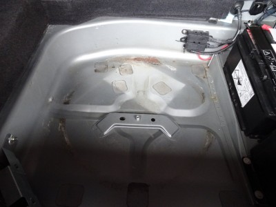

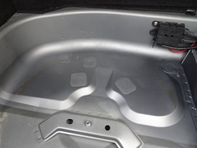

Here are a couple of photos of our boot from when I was having some rust removed if they help.

Mine, that has never been disturbed, has that same square patch in that corner as Lucky's second photo. The battery vent goes through one of two grommeted holes right in the corner in front of the battery.

Thanks to you all for replying so quickly. Mine is exactly like Luckys first photo, just under the high power module.
Since one of Luckys photos shows a patch and the other photo a hole does it matter if it’s blocked off?
I guess not.

The hole was only there whilst they were carrying out repairs. It is now covered over again.
