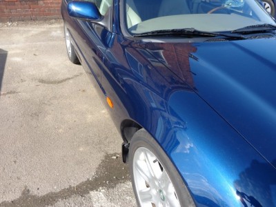

Hello everybody,
I am pleased to say that the situation with the faulty car cover has been amicably resolved.
I have returned the cover and received a full refund and the car has been professionally polished free of charge at the main dealer workshop in Canterbury. I have attached a few photos of the car as it is now.
After raising the issue with the main dealer I was asked to bring the car to the dealership for it to be looked at. Whilst there, three employees of the dealership looked at the car and within moments said the damage was caused by the cover and a repair was in order.
A few days later I took the car to the body shop to have a panel test polished to see if that would rectify the damage. Afterwards, I was told to keep an eye on the test panel looking for a return of the white discolouration or white pin spots, either of which would mean that polishing would not work a complete respray was the only course of action. During the trial visit to the body shop I also was told not to use a cover of any kind that touched the car as these can trap moisture against the body causing discolouration.
I am pleased to say that the polishing was successful and the whole car has now been polished removing all the damage and giving a most satisfactory shine to the car.
So I now face the decision of a having a new garage built or finding a “non-touch car cover”, watch this space as they say.
Given the painless (though worrying at the time) resolution I feel it is only right and proper that I express my personal gratitude to Paul Dickerson who is the Parts Manager at Barretts Ashford. Paul worked resolutely and without fuss in the background and without his help the outcome there might have been different. The parts team in Ashford have always been an outstanding bunch and now I have had the benefit of Paul’s support I can see why.
Whilst there was no admission of fault, I was told that JLR paid for the repair work.
Doug Barrass.
Ashford, Kent.
