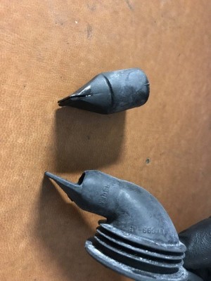

Hi Trevor, the type of Ducks Bill used in the New XK changed during 2009, with the c/o being at VIN B34500, so cars in 2009 could still have the older, easily blocked version, whilst the 2010 MY cars will definitely have the newer version. In the photo below, the older / original version is at the top and the new / improved version is at the bottom.
Jim Mann
