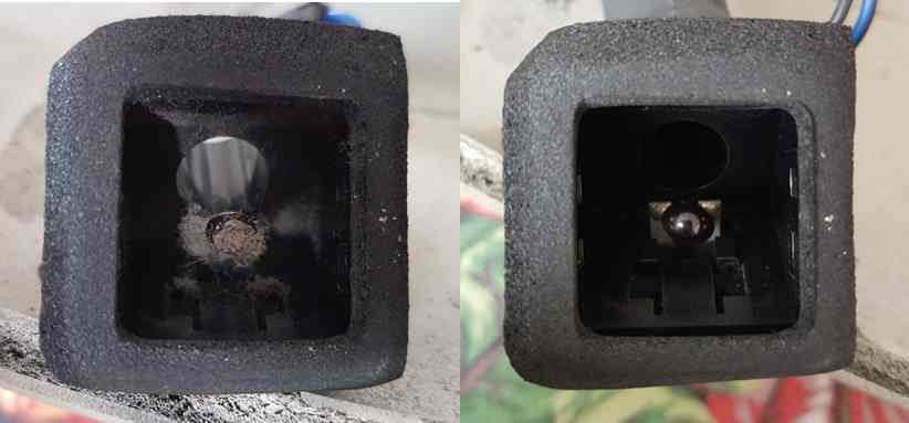

Postby mikeanson » Mon Aug 14, 2017 7:52 pm
Got the little chap out - not too difficult either. It was rather fluffed up as you can see. A gentle clean with a small paint brush was all that was required to transform the gunged up thermistor on the left to the gleaming bead on the right. While everything was out, I took the opportunity to plug the whole aspirator assembly in to check that the fan did indeed spin - it did. The thermistor measures about 1.4 kOhms at room temp and reduces as I warm it with my finger, so I guess that is ok too. I'll check it all out on the next trip.

Re: Interior Temperature Sensor
Postby BrianG » Tue Aug 15, 2017 8:51 am
Well done Mike! It looks a lot easier to get at than the XJ was. Let's hope that fixes the problem.
