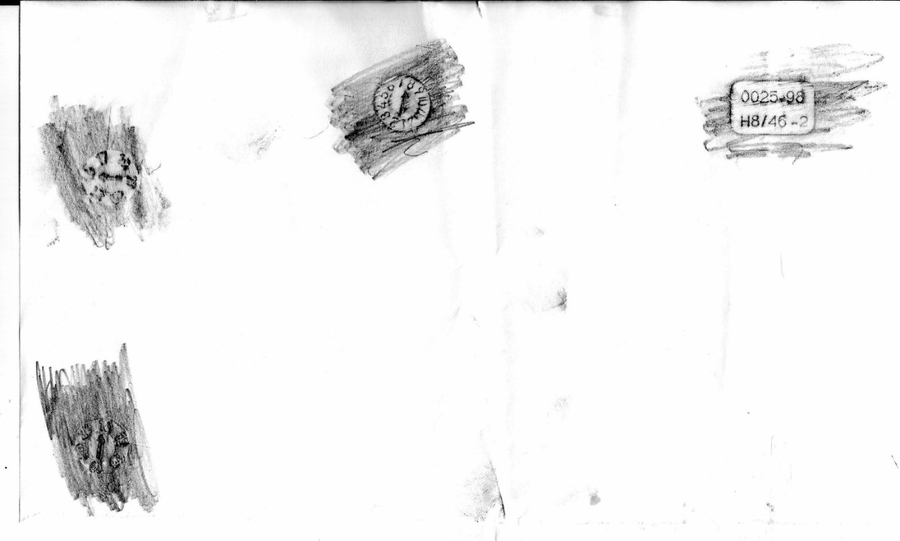

My last XJ8 had an OEM battery in the boot
But no docs to show when it was installed.
There was no date code on it
-- unlike Varta for example that have manufactured year and month embossed (conveniently) on the underside of the case in a time clock format: In January of this year, that battery showed as less than ¼ life remaining with a terminal voltage off load after car not being run for 24 hours of only 12.3V Varta Blue range offers a four year life
