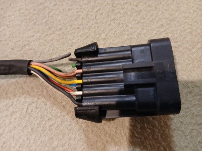

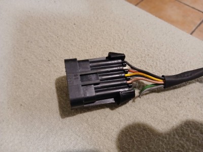

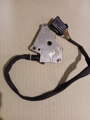

Bill found that the problem was not actually the Range Sensor itself but was a broken wire in the cable - see photos attached. If I can get the wire repaired, I will now have a spare.
