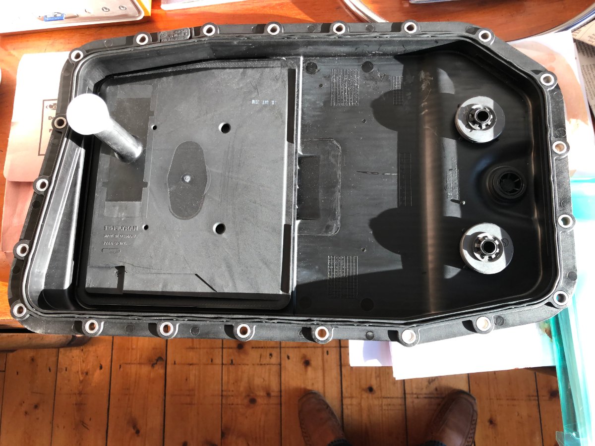

2 pics:
small bottle of fresh ZFLifeguard6 fluid
and sample of fluid drained from my vehicle
previous bolts from ZF sump and filter
2 pics:

(Yes sump pan, (which was renewed-see pic) has two magnets)). There was a small amount of very fine "dust" around each of the two magnets on the sump pan that came off.
