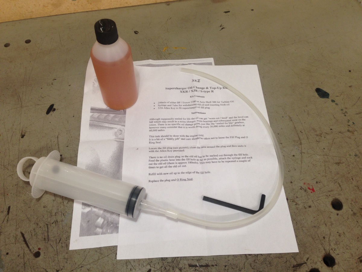

I bought an excellent kit from XKZ via eBay. As you can see it's very comprehensive and includes well written instructions with pictures, the replacement oil, a syringe and the right size Allen key for the level plug. There was even a sheet of kitchen towel for mopping up the spills!

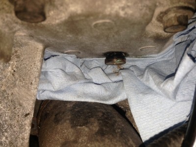

First job is to locate the filler plug. There is no drain plug. We must open the level plug and then suck the old oil out using the syringe provided.

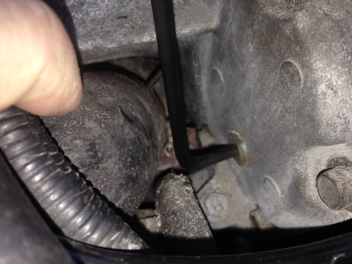

Here's the level plug at the front left side of the supercharger with the Allen key inserted.
I was warned that the plug would be hard to undo but mine didn't fight too much making me think that maybe someone had been here before. My car has just gone over 100k miles so I'd hope I'm not the first to do this job.

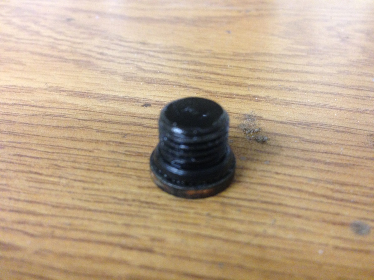

And here is the plug removed

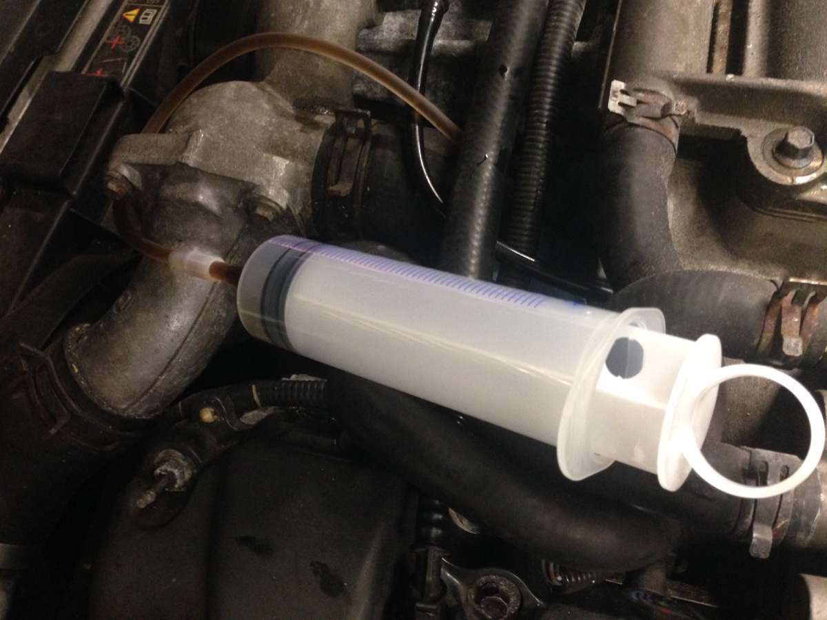

I used the syringe and supplied extension pipe as below. It's important to make sure that the end of the pipe gets past the front of the rotor and down into the oil.
I filled the 100ml syringe once and then mostly filled it a second time before I felt I'd got all the old oil out I could.

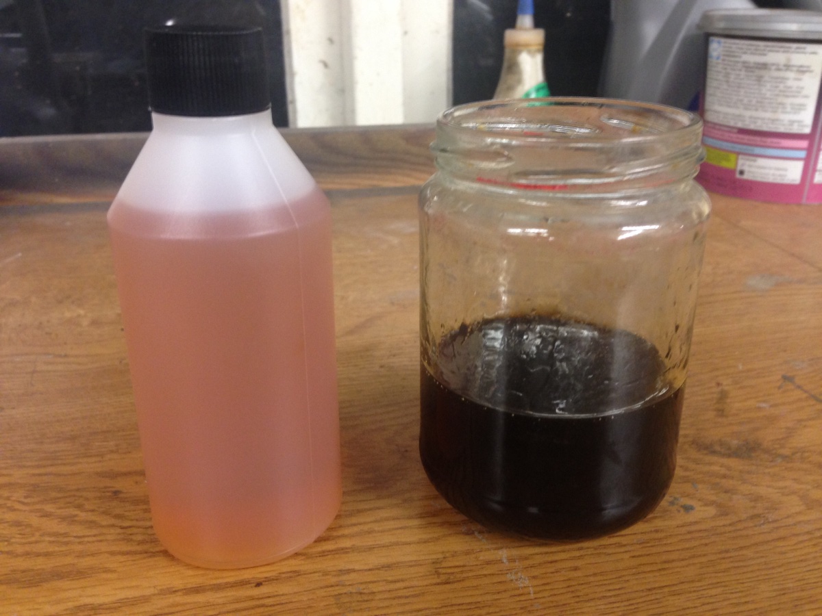

And it looked like this
The instructions said there is 180mls in there so I thought I'd measure what I got out
So I got out just over 150mls
Next I used the syringe to put in the new oil. I got more back in than I got out but I'm told that's normal.

As you know, David, scheduled oil changes on gearbox and supercharger are manufacturer suggested every 60K miles. 90K on the diff but that in my opinion is too late. Diff oil gets a hard life so I`d change that every 50-60K miles.
Looking at the used oil quality, it appears to still retain some viscosity. The colour although darkened is not outrageously blackended. Badly neglected oil don`t half pong. Akin to rotten carrots! As your oil wasn`t too smelly and the fact that the screw plug wasn`t too difficult to remove, might perhaps suggest the charger oil may well have been changed previously before hitting 100K miles. One would hope it was actioned at or around the 60K mile service schedule.
