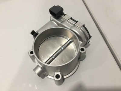

the English company https://www.pinkbatmotorsports.com/ is building one new TB for 4.2L supercharger versions with electrical connections.
diameter: 83mm
ready soon..
diameter: 83mm
ready soon..
