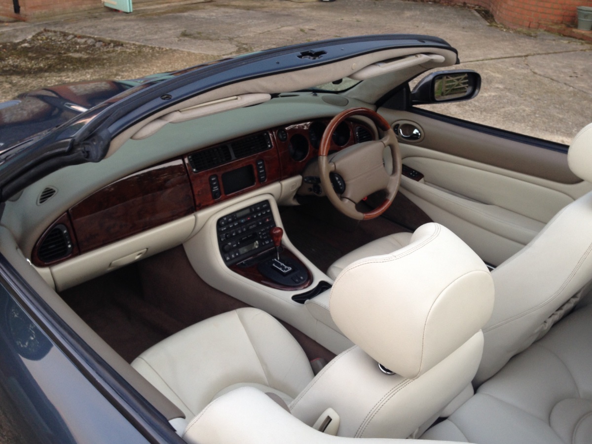

I had to take the radio out to get the serial number so I could use one of the online services to get the code. This means taking the centre console out which is a bit of a pain but doesn't take too long. Care has to be taken when removing the gear lever surround not to break the plastic tabs. An old credit card is the key. I'm pleased to say that worked and now my stereo and satnav are working.
I also put all the boot components back together.

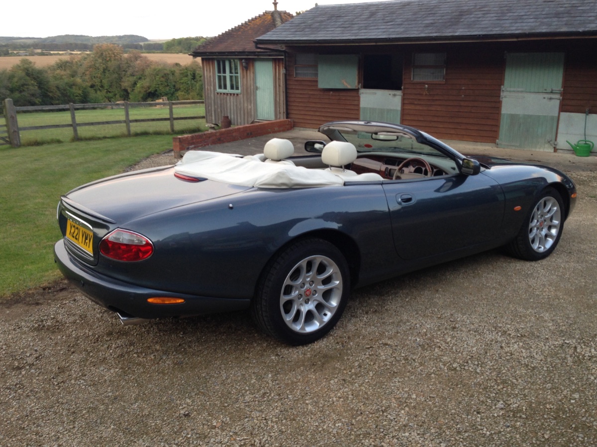

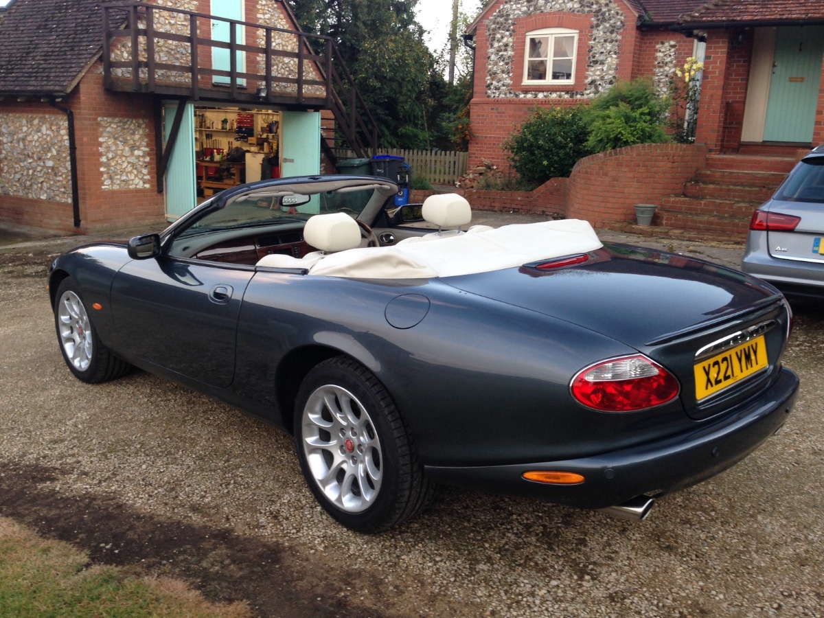

That left a bit of time for some tlc so I have the car a good wash, polish and wax. Didn't she come up well? I also sat myself down and made a list of all the remaining jobs of which there are many!
