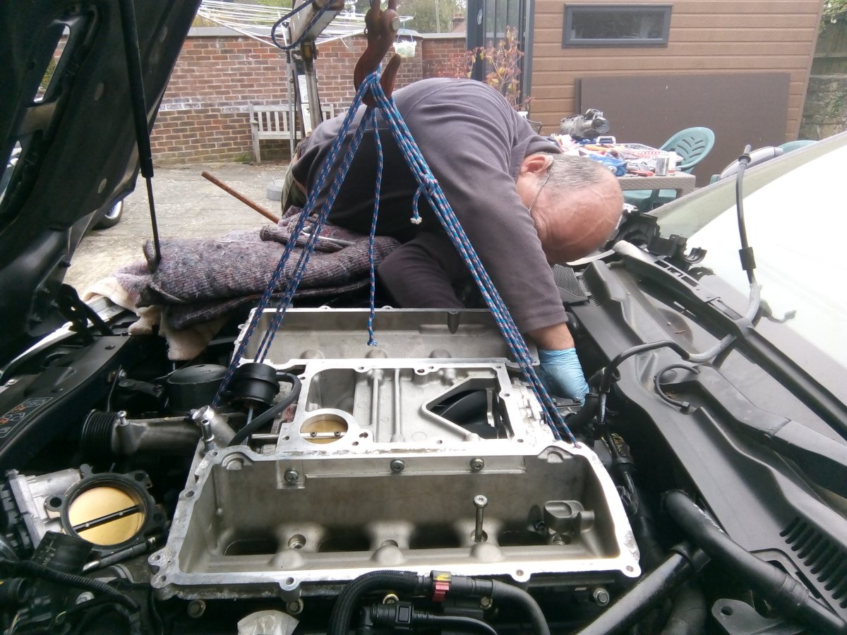

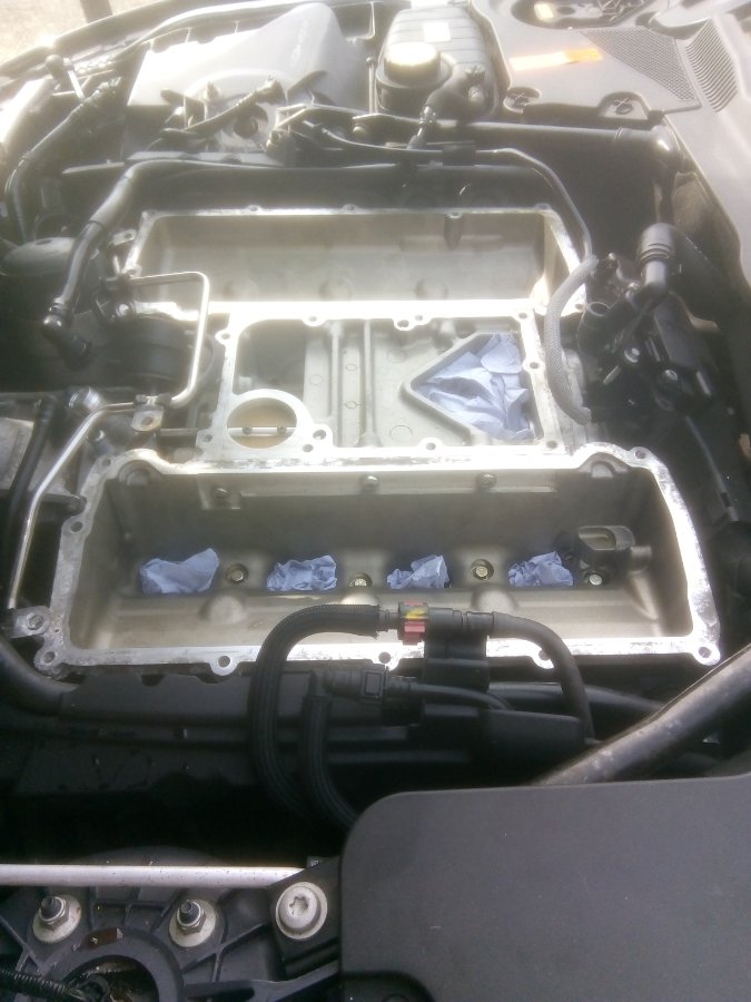

We were now ready to remove the top cover off the supercharger – 23 torx set screws in total. Be careful – there is 2 long bolts (setscrews?) at the front end (1 per bank). These are a bit tight to remove (we undid them a quarter of a turn, sprayed them with wd40 and left them whilst we had a tea break!). Once the top was removed, we found 8 bolts securing the supercharger to the inlet manifolds (4 per bank). Before removing these we blocked the exposed unlet ports, in case we dropped a bolt or other small items down them by accident. Once this was done, we tied Kevlar rope through the vacant holes nearest the main supercharger body (4 holes) and secured it to an engine crane. We rechecked that there were no more hidden bolts and proceeded to lift the supercharger off the engine – worryingly, it seemed that we were lifting the engine as well! We tried some gentle persuasion with a pry bay under the supercharger (against the brace bars), but it didn’t want to budge.
At this point we decided to release the strain off the engine crane and double-check if we had missed something. So we had another tea break and tried good old Google, to see if we could be enlightened – but we didn’t seem to find anything to help us. So I phoned Mike Horlor to see if he could help, but although he could view some information, it wouldn’t let him download anything to forward to me. I then managed to download the XK workshop manual and spent a lot of time sifting through the pages – the pictorials were good but didn’t explain the removal process very well. As a last bid to obtain some better advice I phoned Rob Jenner, who gave me a couple of contacts that may be able to help. Unfortunately one was uncontactable that day and the other was not available until later in the day!
Then Alan had a light-bulb moment – he remembered he had the old supercharger in his garage and it might help us to see what the problem could be. Our doubts were confirmed – there were no more concealed bolts or attachments underneath the supercharger that could be causing any problems. But there are 2 hollow locating dowels that sit in the vee, so we could only assume that these were a very tight fit or even slightly corroded making removal difficult. So we tied the supercharger to the engine crane once again and tried to lift it, whilst gently levering in various areas, taking care not to do any damage. It still wasn’t going to give in and I think, at this point, Alan was getting a bit miffed (and he was a bit busy on and off because he runs his own business from home) and was very worried we were going to break the supercharger casing.
At this point, Alan took a break and went indoors to conduct some business, leaving me to carry on. I decided to take a risk (because we knew no bolts were holding it in) and put a bit more strain on the engine crane and use the pry bar with a bit more force (very risky on someone else’s car!). Thankfully, after manipulating each corner of the supercharger casing for a few minutes, it came away from the engine with a pop! But BEWARE – the valley pipe is held in place, to the underside of the supercharger, by 2 plastic clips – so don’t use too much force.

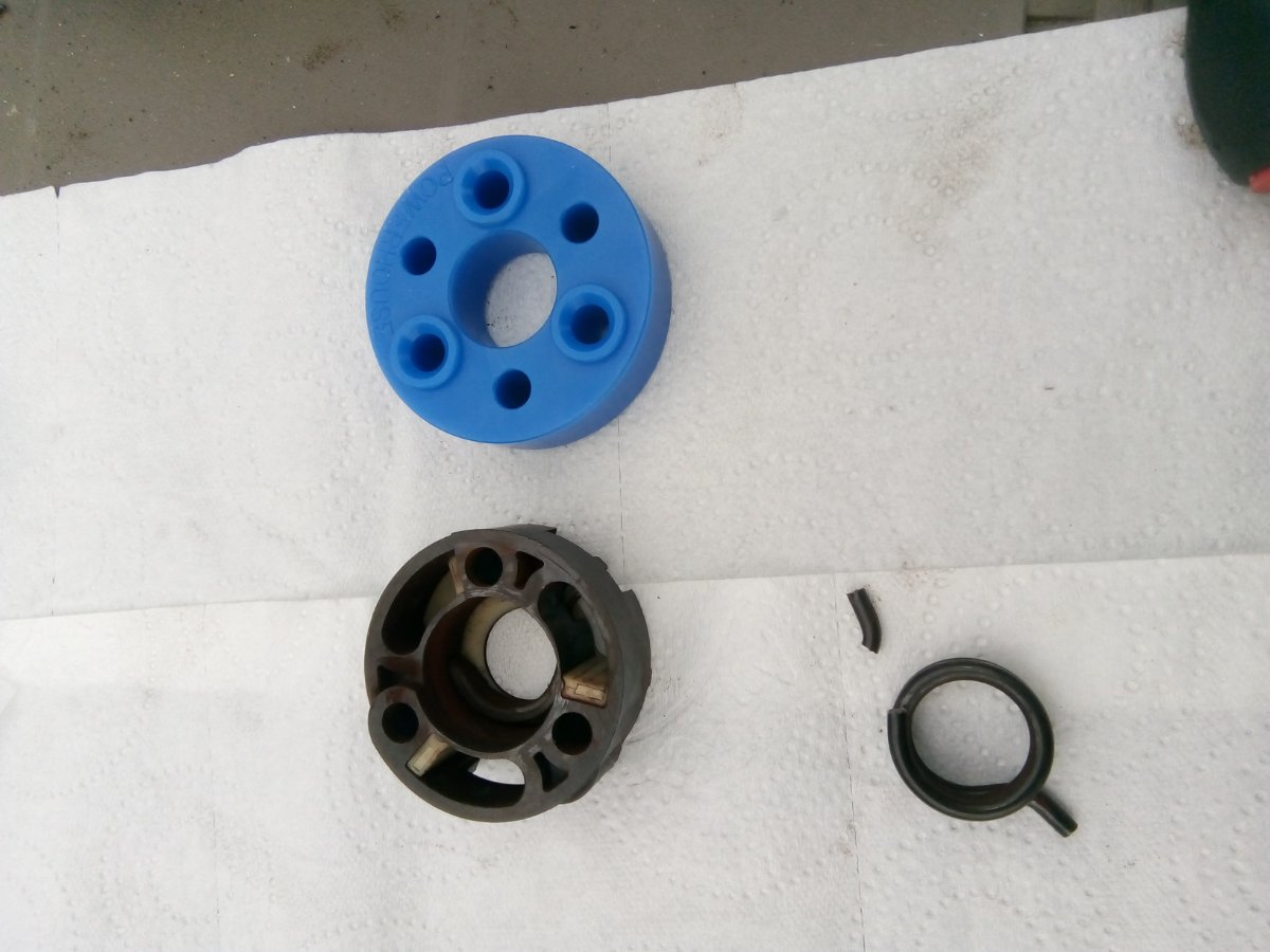

After checking the shaft , for any play or damage to the bearings, we decided that the only ’wear and tear’ was the coupling and spring. The coupling was replaced with a doughnut from Powerhouse (who also supplied the oil refill kit we will use shortly). The mating faces were cleaned and new sealant applied (we don’t know if there should be sealant, but the flat surfaces were not 100% smooth, so we played safe) and bolted back together. A quick spin by hand, on the pulley, confirmed a successful fix.

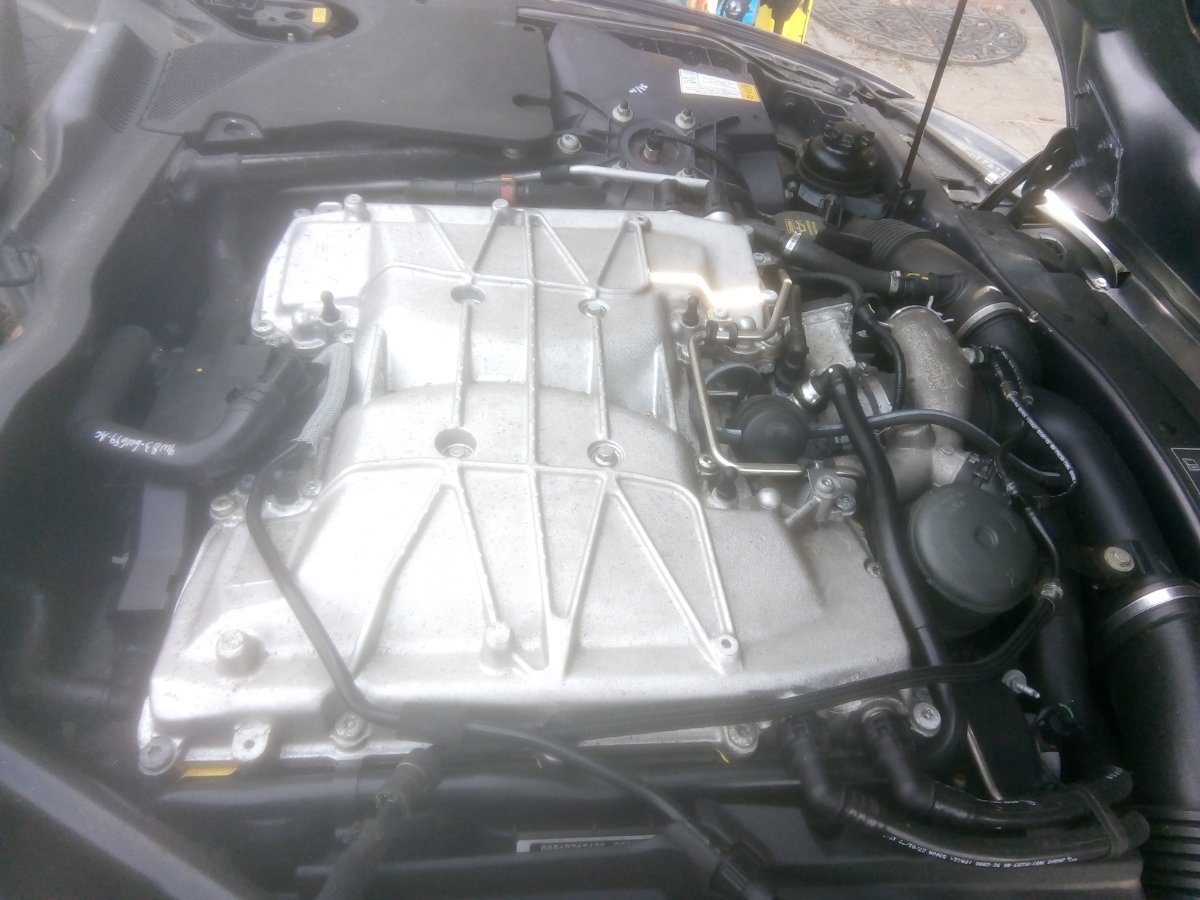

Re: A Tale of a 5 LTR XKR Supercharger Removal & Maintenance

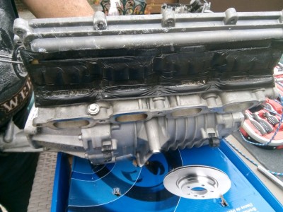

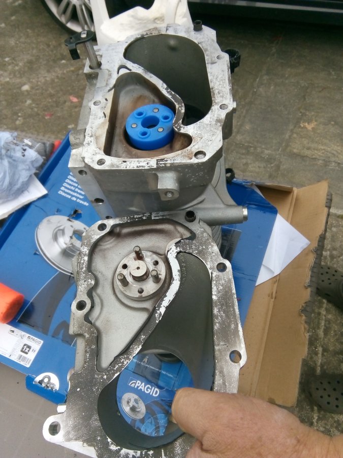

Some more pictures.
The middle one shows the old coupling, with a broken spring (hence the sound like washers rattling around!).
The blue doughnut is the replacement (no spring to worry about!).
The bottom picture is the supercharger being guided onto the engine. You will notice 1 of the long bolts mentioned in the write-up (there is another in the opposite side (bank)), to ensure it lines up with all the bolt holes.

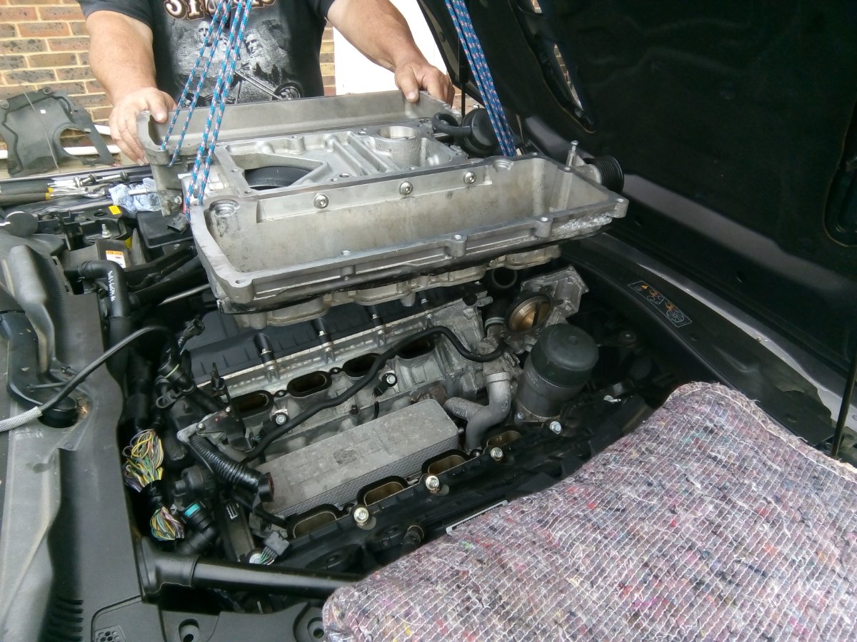

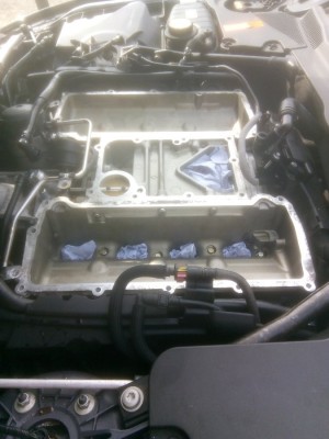

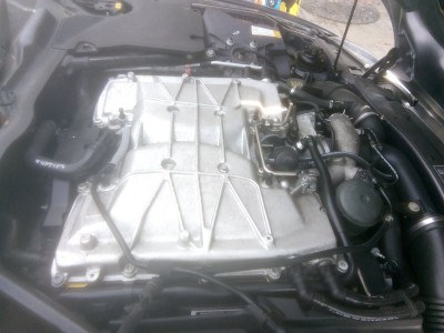

Top picture shows the supercharger being lowered back onto the engine.
Middle picture shows the underside of the supercharger. Here you can see the locating dowels and the 2 clips that the valley pipe is secured in - so you have to be careful when removing said supercharger!

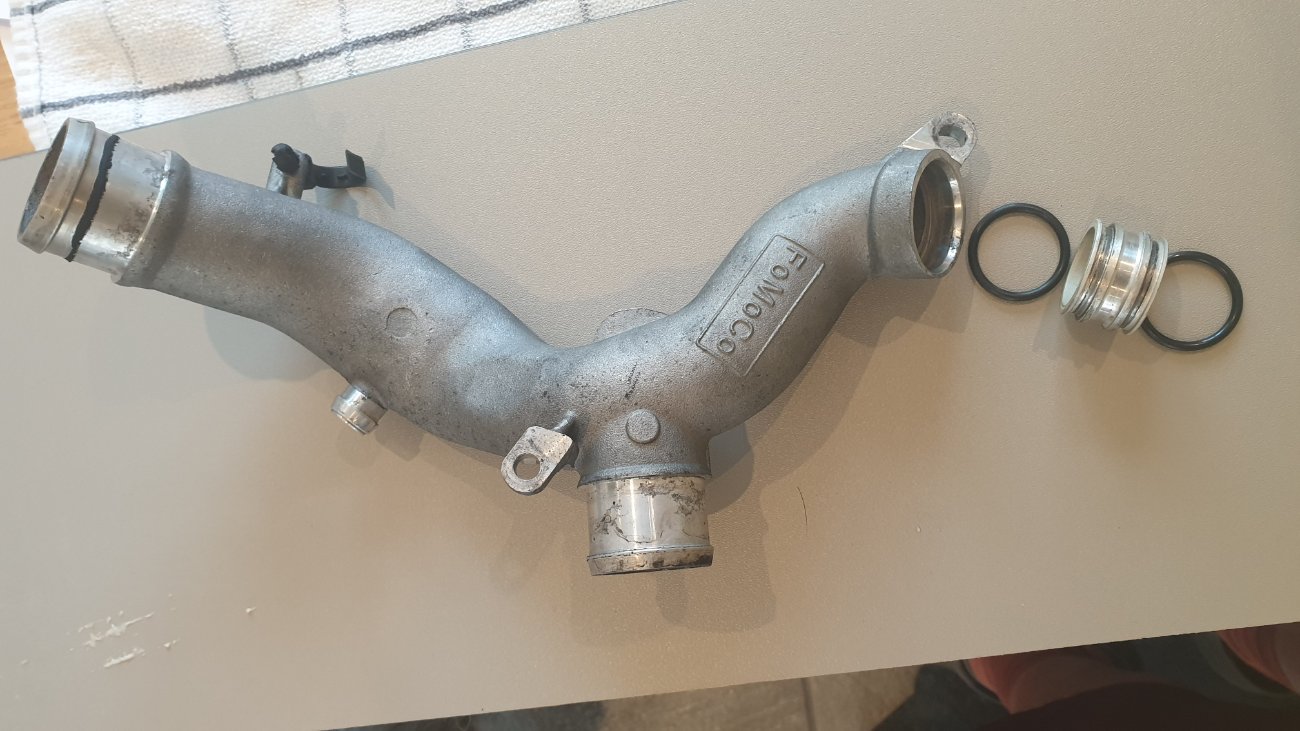

Bottom picture shows the front coolant pipe (it is upside down), with the small insert that we lost (?) and the 2 new 'O' rings.
