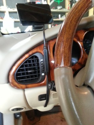

I put in a socket in the small compartment below the steering wheel. Took the power from the lighter socket via some cables routed below the interior trim.
This way the connection is hidden, but you will have a visible cable from the box up to the nav unit.

It may be possible to route the cable from the small compartment through the ventilation grill on top of the dash, just below where I have located my nav unit.

Postby oyster » Wed May 27, 2015 6:36 pm
Hi again.
I have been driving with the wires as in the picture in my previous post, for more than three years. After you brought it to my attention I had to do something.
- The vent grill is not a good solution. You would have to drill holes in the ventilation duct.
- Dash speaker is neither any useable way to go. Again drilling holes and interfering with the speaker.
- The solution was to remove the A-post finisher, route the wires from the top, down to the facia fusebox, and further on to the socket in the small compartment at the knee bolster. After putting the A-post finisher back, the wires are almost unnoticeable.
WARNING: As you have a 2004, you might have an occupancy sensor in the finisher, but I think it is only on the passenger side. Disconnect battery when working on electrics.
My socket is further wired to the cigar lighter, this to avoid any interference with the touchy electrical system. This connection has no power with ignition off, so my Garmin nav unit turns automatically off when I shut down the car and back on upon starting.
