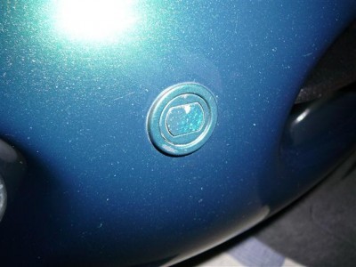

Here are couple of pics of current ones anyway.

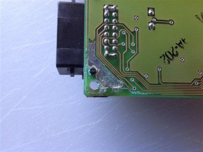

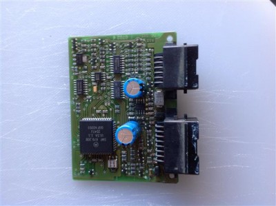

Well at last a sunny dry day so decided to investigate further, unplugged unit and tested reversing car, no sound so it must operate front and rear. Not a sealed unit so opened up and a right mucky mess inside, cleaned out with soft brush and looks like could be water damage in one corner
Could this be the root of my problems? Is this unit classed as an ECU so it could be sent away for test, repair (hopefully) or replacement (if I can find one). Anyone recommend a good place to send it?

The last time I needed a reversing sensor ECU, I bought a second hand unit from Eurojag at Darlington. They advertise in the magazine and often list components on Ebay. Make sure you get an ECU with the same part number as the one you have because there is more than one type. Mike.

Result
eventually sourced a part ( new ) from David Manners and cost less than couple of quotes I rec'd for repair of old one. Fitted and switched on and I now have front parking sensors that work
