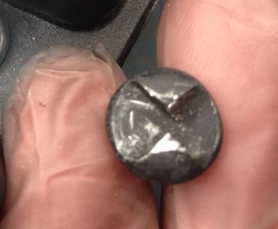

If they are the same security screws as the X308 which are like this:
I got them out with a flat head screwdriver and light pressure,they're not that good.

Thank you for all the advise, seen John (To The Garage) on YouTube and using a large flat screw drive as also advised by Andy - and hay presto - they are out.....luckily the gearbox issues have not reappeared but at least I can get to the transmission control unit if required....
