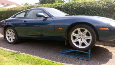

I'm currently working through the restoration of this 1996 Coupe and it's time to address the fault codes. Is there a link anywhere to the code list for this model?
The codes showing are: P1637, P1638, P1643, C1165, C1175
Any help diagnosing the codes will be greatly appreciated. The car has been stuck in a barn for 8 years and is slowly coming back to life.
Jobs done so far: New fuel pump, new brake pipes, new Cats.....
