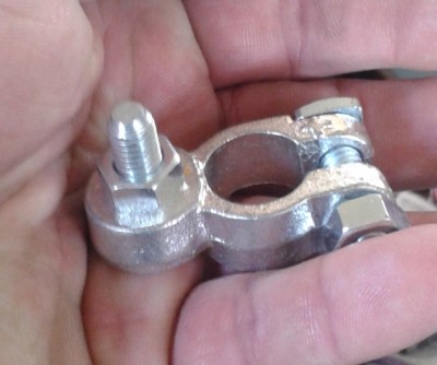

Just dashed out to check mine :!: mines tight.... but I would be interested to see if your fix with the Ford type clamps... do we not already have those "Ford" ones on the Jaguars? :roll: , sorts your problem.

Not yet got around to this mod on my S-type, but here is a shot of the typical Ford clamp. I always install a rubber insulation boot over the whole unit to avoid short circuit possibilities.
Use of this type of clamp requires the OE standard fit +Ve (or indeed a -Ve) heavy load cable termination to be cropped off. The cable insulation then has to be removed by about a half inch and a 25x8 plated copper cable lug fitted to the cable. It is then squeezed with a heavy duty crimp tool to form a permanent fitting. The 8mm refers to the size of the hole in the cable lug end which corresponds in size to the vertical stud and nut arrangement atop the battery connector. The 25 refers to the cable size cross sectional area in square millimetres which on my S-type is of that dimension.
These battery connectors are easily available from ebay and other outlets. Avoid similar looking units which may have a tube and two screw fitting for easy cable fitting. The two screws are wound down through exposed cable and are supposed to give a reliable connection. In practice that frequently does not occur and a dodgy termination is often the case with this type of battery termination. Avoid like the plague in my opinion.

Measured the temperature in my original battery cables with engine off and some high consumers on.
To my astonishment the temperature around the positive clamp was 50C. Ambient temperature 20C.
All other connections were ok.
Tightened the clamp fitting in a vice, but as you say, changing the clamps is probably a good idea.
