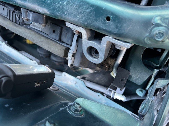

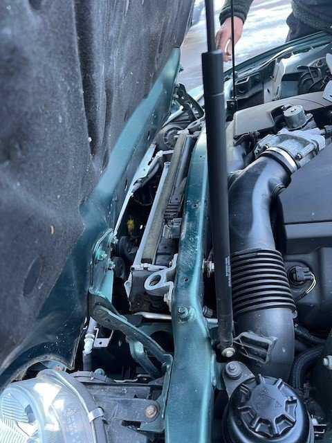

The lower set are grey down in the back of the bumper. The upper black ones are on the cross member above the radiator and can be seen once the plastic cover is taken off. See pictures below although the lower sensor is difficult to make out. I am thinking that the upper ones are something else as the pedestrian would be well dead by the time that sensor is hit ...?

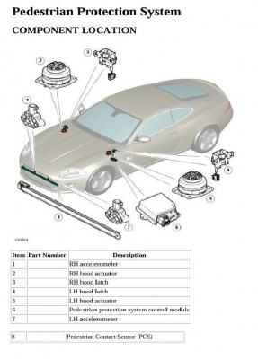

As an XK8 owner/maintainer, I don't have any direct experience of working on this system, however, I do have in my technical library/collection, a document with a detailed description that will accurately put you and your garage in the relevant picture. There are two upper sensors that are accelerometers and a single broad impact sensor across the front of the bumper beam, behind the bumper cover. How and what they do is covered in detail as well as diagnostics and how to remove and replace them.

The diagnostic code quoted refers to the left hand pedestrian accelerometer (item 7 in Astromorg's diagram) which is listed by Jaguar as part number C2P5129 (£84.34 + VAT). Mike.

Thanks. Mine is the X150 version. I think Astromogs diagram is the older XK8. Is the part number the same?The diagnostic code quoted refers to the left hand pedestrian accelerometer (item 7 in Astromorg's diagram) which is listed by Jaguar as part number C2P5129 (£84.34 + VAT). Mike.
Luckily my garage say they can get to it without taking the bumper off.
I’m wondering if the other sensors on the cross beam control the airbags inside the car which would go off in the event of a more serious crash?
In fact a search of SNG Barratt shows them as part number C2P3922 'Front Airbag impact sensor'. This may be why second hand ebay sellers have got the two parts confused.

The diagrams and information from Astromorg is for the X-150 model.
