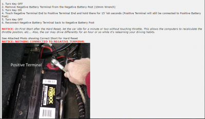

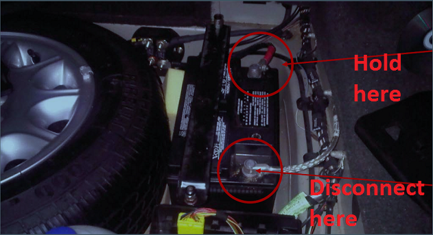

If I had an issue like yours the first thing I would try is a Hard Reset.
Follow the instructions in first photo(MAKE SURE YOU HAVE YOUR RADIO/INFOTAINMENT CODE FIRST) The Hard Reset can fix a lot of issues relating to the electrics.
Might be worth a try.Sorry I can't be more helpful.
