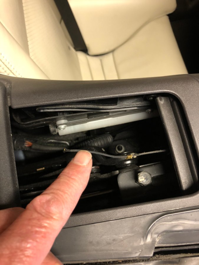

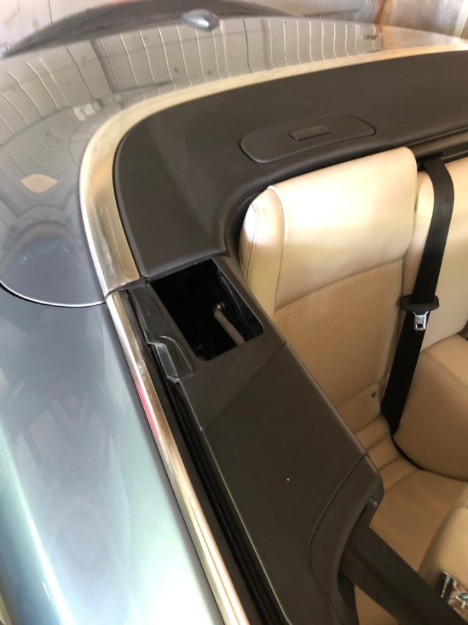

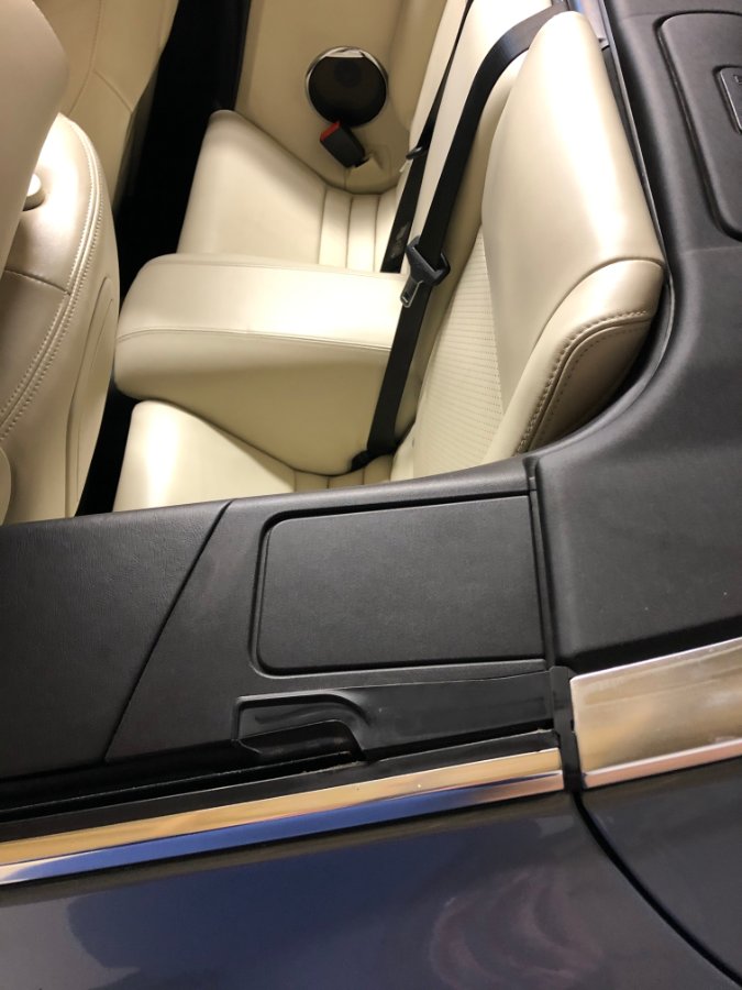

On my 2009 XK convertible, whilst the opening and closing of the hood are operating correctly, after my latest short trip the rectangular shaped hatch that is pulled open to take the parts of the hood as it folds backwards remains open, (as there is a cable which has come adrift/parted).
Hope the pics (including the OK hatch on the passenger side ) help on what I am trying to describe.

As far as I can see there is not actually a broken or missing component. Rather the wire that is connected to the spring/pump that activates the rear trim moving plate has come adrift from the wheel on the part of the hinge that it is looped onto. I can see the crimp that allows the end to form a simple loop (some deft videoing of the operating passenger side allowing me to see what actually is going on!).
Ironically the best access is right there at the open rectangular hatch (rather than coming from underneath say).
Therefore I believe re-making a loop on the wire/cord I might manage. But I wonder if the trim plate itself has had its "lugs" dislodged out of its tracks? Anyone able to say if the trim plate should move easily when not held by the wire/cord?
Finally, to re-loop the wire/cord onto the moving hinge piece I think I would have to "freeze" the closing of the top at an optimum position to allow to do this. Grateful if anyone has general advice on stopping the opening/closing by releasing the button...., (something I have avoided in all my short time of ownership). I appreciate the battery must be fully charged for all this sort of operation.
