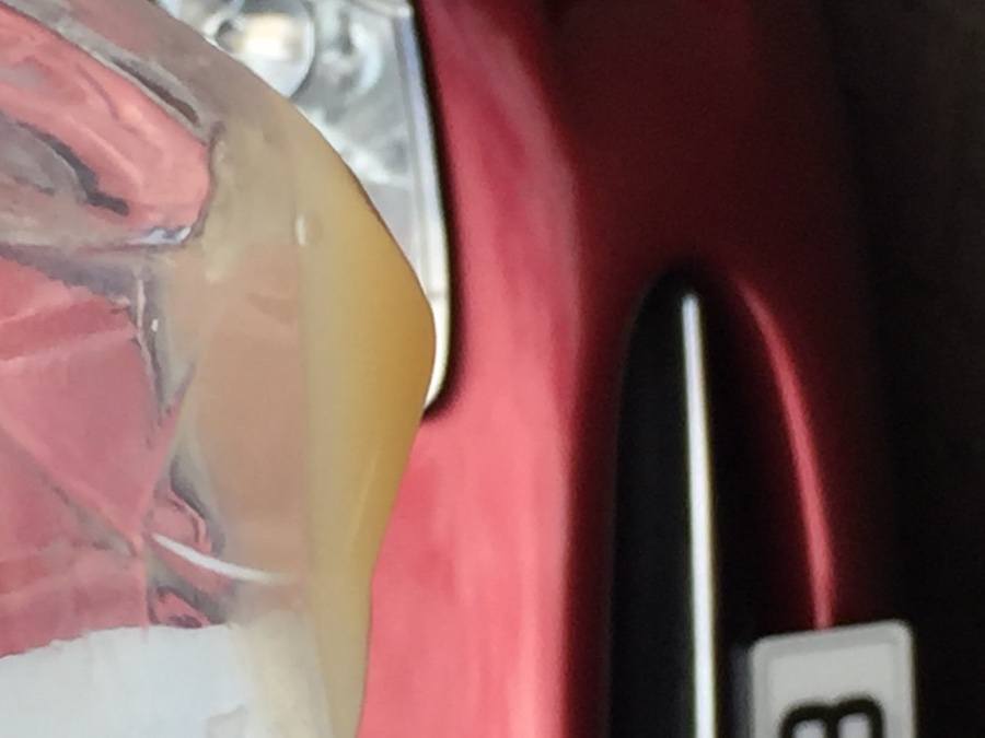

I just took out coil on cylinder 7.. I can barely see the tip of the spark plug it's full of liquid... is this my coolant seeping is or something else :roll:
Some quick advice please as I have it open .. what shall I do 🤒

Photo attached .. any tricks to suck this liquid out

It's definitely not oil so plug gasket is ok.. I'm surprised so much of the coolant has seeped into the plug well despite the plastic cover protecting the coils 😶🦂🦂🦂🦂

Well, there's little doubt why the poor car was misfiring! I hope all will be fine once you have extracted all that water and dried out the entire area. Mike.
